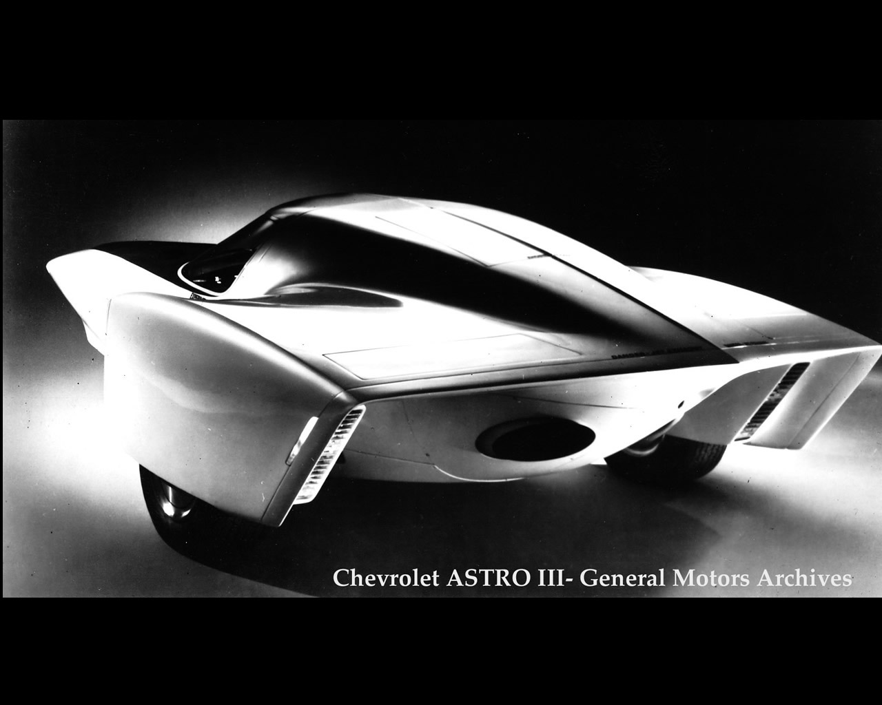

anyway the deltawing reminds me of this 69' project car the 'xp511 commuter vehicle'
or the 69' chevy astro 3 concept
or the harp jetmobile of 1955
or the 2011 bluebird
frankly, i can't be bothered at all with this hideous deltawing. i think it's a copy of concepts of decades ago,
and i fail to see the use and positivity of this 'thing'. it looks totally out of place and it just looks weird between
'real' cars. it's neither special because there have been various similar designs dating back to the 50's. that's 60 years ago.
i remember an old book of the late 80's early 90's i had in a collection but unfortunately lost in a fire when i saved it in a shed while moving and the shed caught fire due to a faulty light wire. :cry: the saddest part is, i forgot the name of the book. some encyclopedia-like book. sought at the library to find it back but unsuccesfull. anyway it contained the firebird concepts, bonneville land speed record machines, and much more.
since the day i saw the AAR-developed Nissan Deltawing i immediately remembered i saw something too similar, just don't remember the name.
