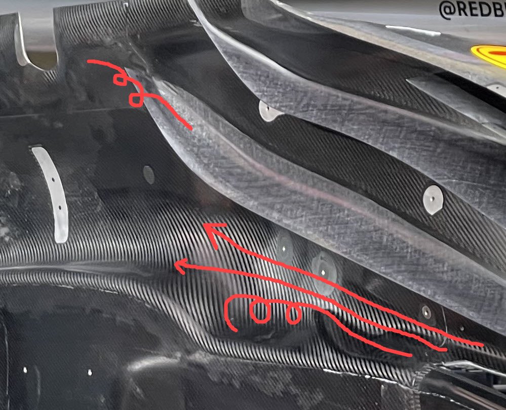

Dont agree with this logic, if you want less airmass than you can simply put plate to the ground at front bumper and stop airflow completly.
Idea is to increase airflow under car not decrease.
Maybe they use vanes to produce vortices to seal side of flor, because they cant use skirts that touch road...

Fluido wrote:
12 Apr 2022, 21:07
Yes they do, you can see on this Latios' picture, focus on the outboard floor edge.
https://pic3.zhimg.com/80/v2-37a5c99e00 ... a_720w.jpg
Problem is all super cars hide pictures of undertray.
You cant find it on net.
