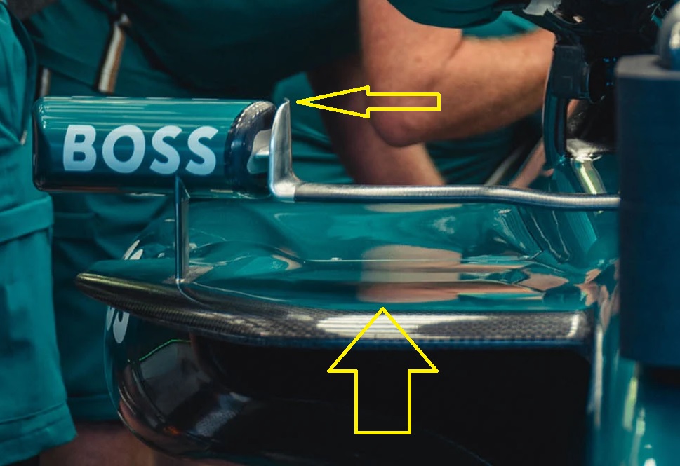

Re: Aston Martin AMR25
Photo form Aston Martin Official Page
I'm not sure if that was pointed out before but it's clear that the top of the sidepod is not flat, there is a noticeable recess/puddle (don't know how to name it) + mirror winglet, up close you can see outwashing shape

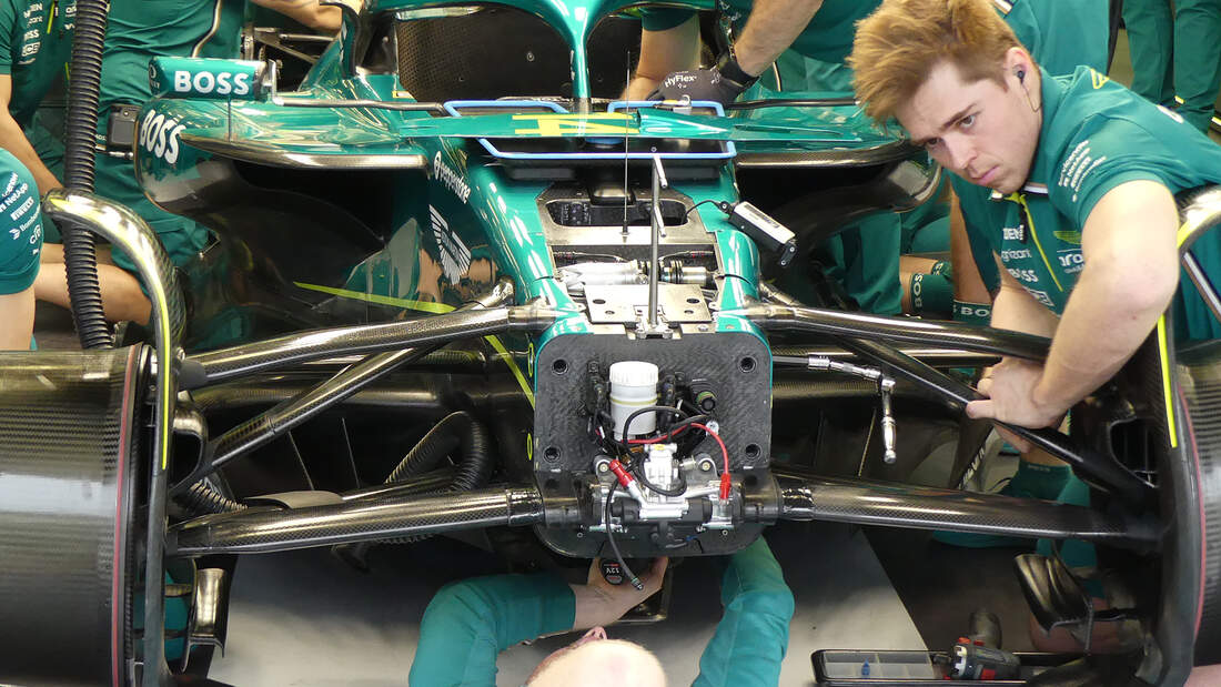

Sherrinford
Sherrinford
Joined: 01 Jun 2024, 00:11
Same front suspension as last year, the Redbull V-suspension should reduce drag as the guy in the post says
