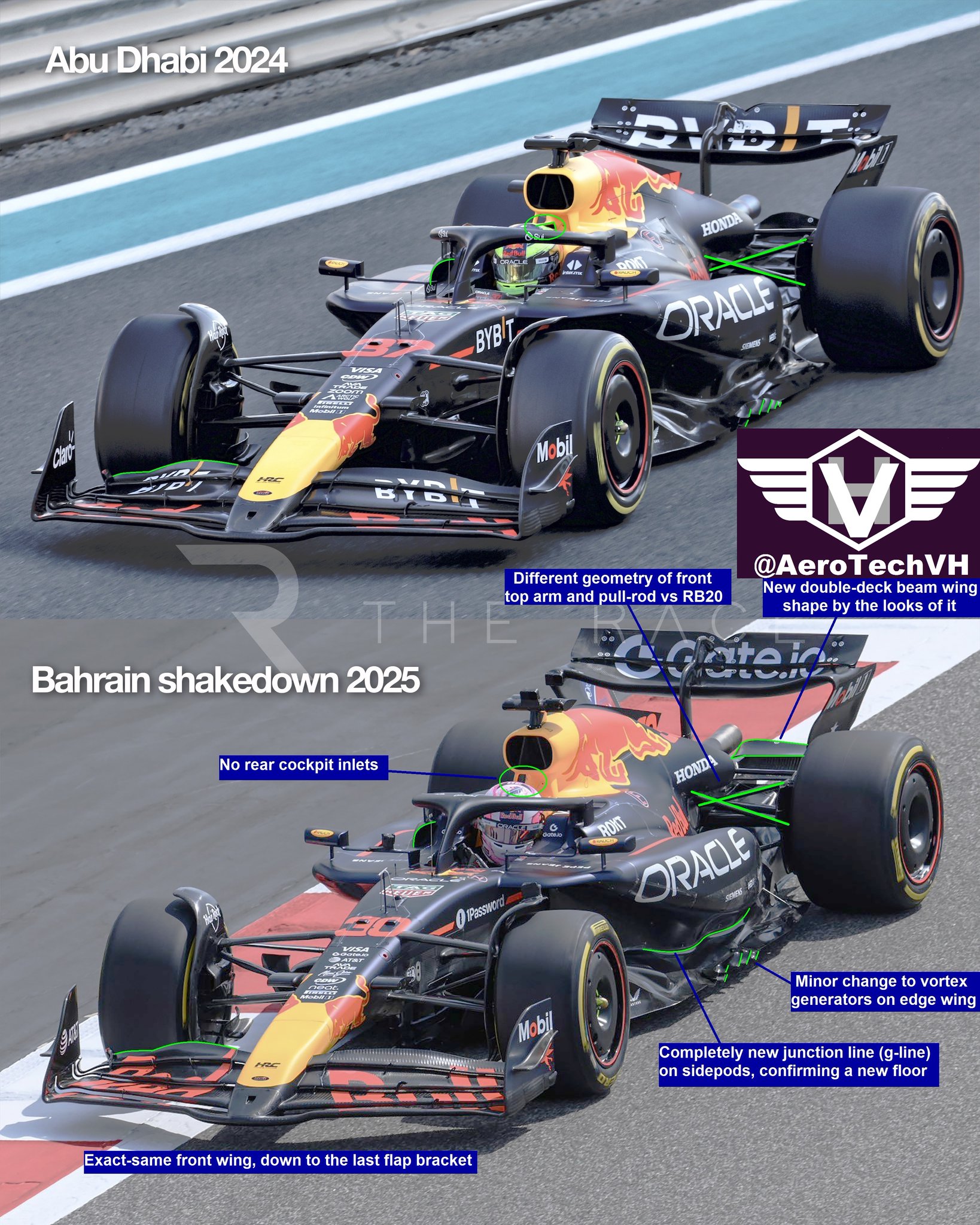

I consider my leg pulled. The difference between the RB20 and the RB21 seems like a particularly minor update. Something is off.
1795
Re: Red Bull RB21

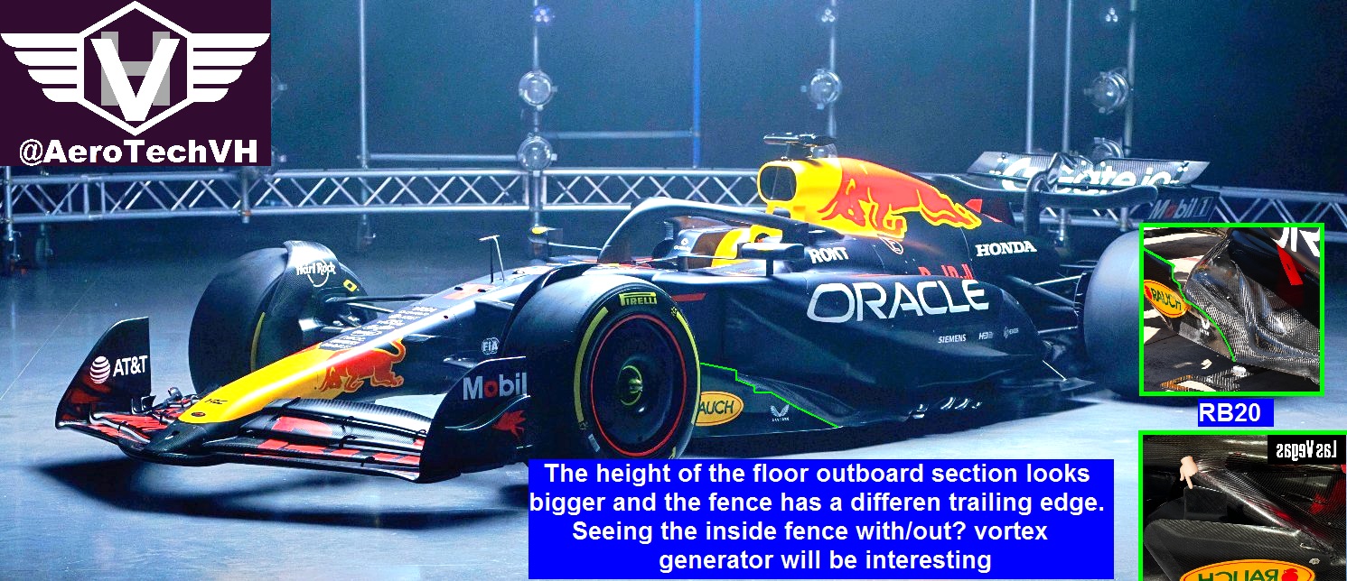

Down below I've listed a couple of important changes between the two cars, with subtle rear suspension changes indicating at least new gearbox case with new pickup points. Can't say anything conclusive about the front though
The floor is new and I've pointed out the things we can see now. There's also a new double-deck beam wing by the looks of it
Not gonna do a deep dive with oldish bodywork and front/rear wing, you can read all about RB18, 19 and 20 here - including the details about their wings, floors and much more:
https://x.com/AeroTechVH/status/1870779346031427881

Henk_v wrote:
25 Feb 2025, 22:37
Could it be that they try to start with a basis similar to last years car but with a better basis, and then add on the update parts?

Vanja #66 wrote:
25 Feb 2025, 22:39
https://pbs.twimg.com/media/GkqPcdEXAAA ... name=large
https://pbs.twimg.com/media/GkqPcdAWkAA ... name=large
I'm really struggling to see a new rear geometry here. I can see the G line and beam wing, the rest looks incredibly minor.
Felipe Baby!
Re: Red Bull RB21
Inboard attachment of pushrod has been moved rearwards.
Upper forward wishbone inboard attachment has been raised + moved rearwards
The race claim the rb21 chassis is the same as the rb20

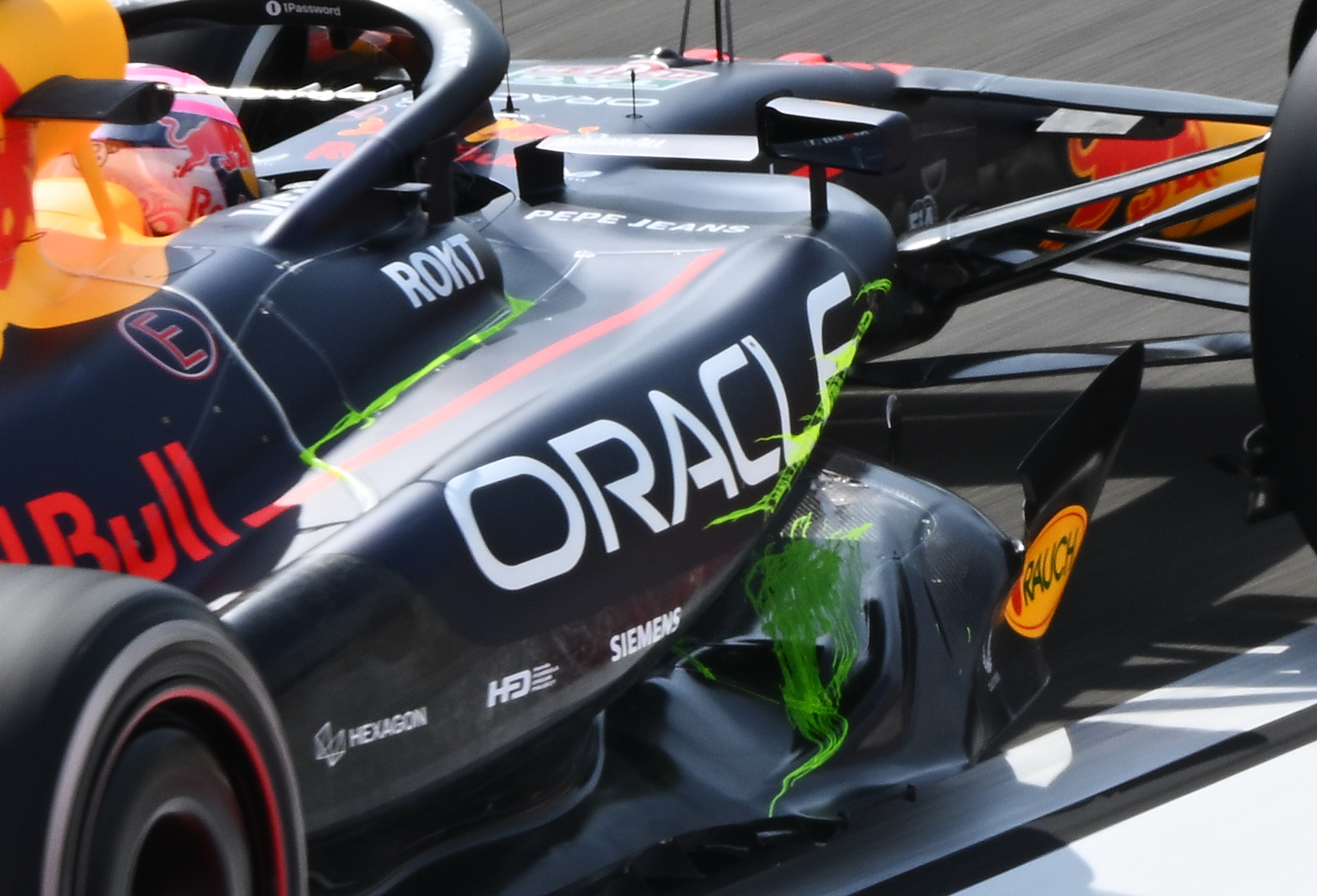

Vortex generating extensions to floor fence that appeared end of 2024 have made it to the rb21 too

Better view of the new g-line geometry
