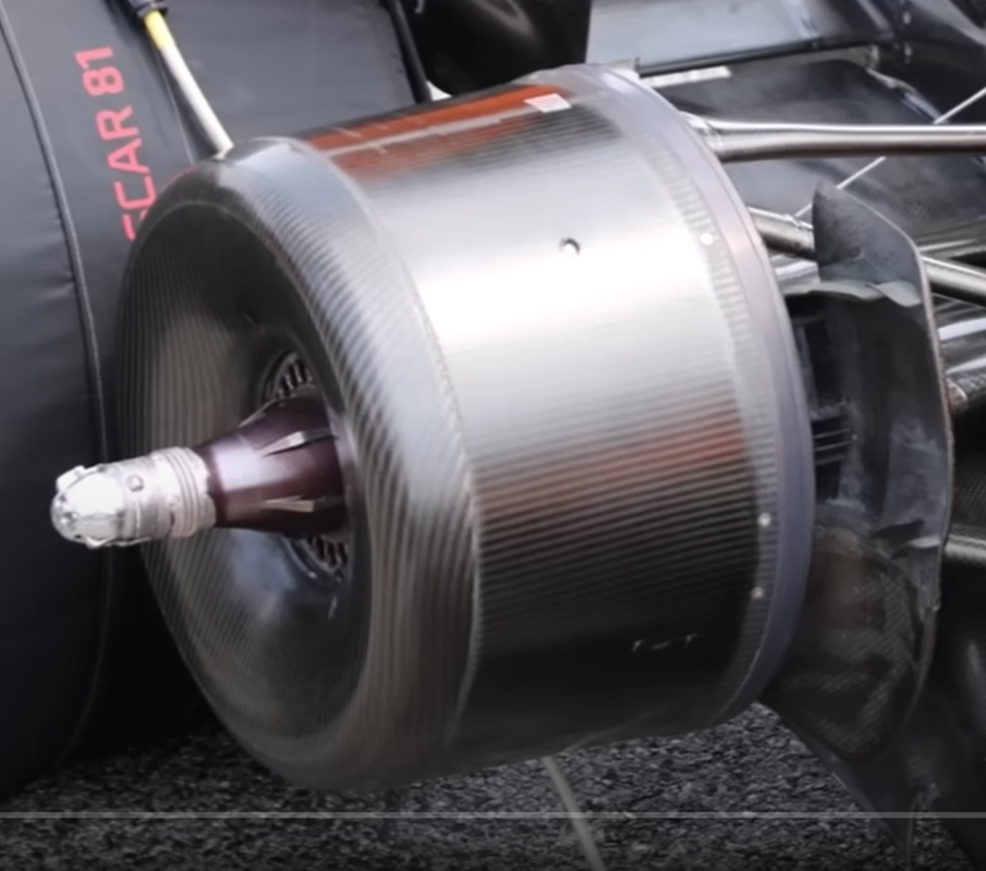

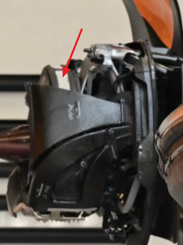

What are we seeing here? This is the Mclaren rear brake. The 3 photos are the 3 compartments. The cover over the rear brake disk in the first photo looks like it is of a mixed composition.

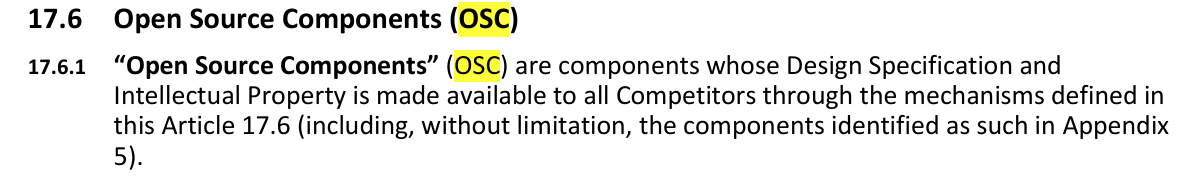

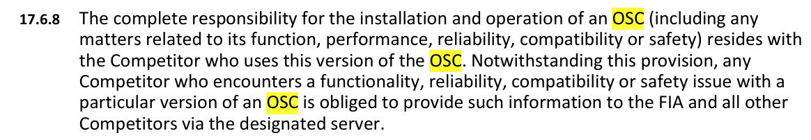

I want to revisit this as I have discovered some new information. There is a category of parts on the F1 cars known as Open source components (OSC) in the regulations.
Here is the list of open-source components relating to the braking system for which competitors must share the designs for other teams.
OSC list
Pedals
Front axles (outboard of the contact surface with the wheel spacer), nuts & retention system
Rear axles (outboard of the contact surface with the wheel spacer), nuts and retention system
Brake disc, disc bell, and pad assembly
Brake calipers
Rear brake control system (brake by wire)
Brake master cylinder
There's also another note about being required to disclose faults encountered in the usage of any OSC design.
Competitors are responsible for the installation and operation of any OSC parts (including from a liability perspective) but there is also a requirement to share information on any problems that arise.
So again, why does he answer like this? What is he hiding?
