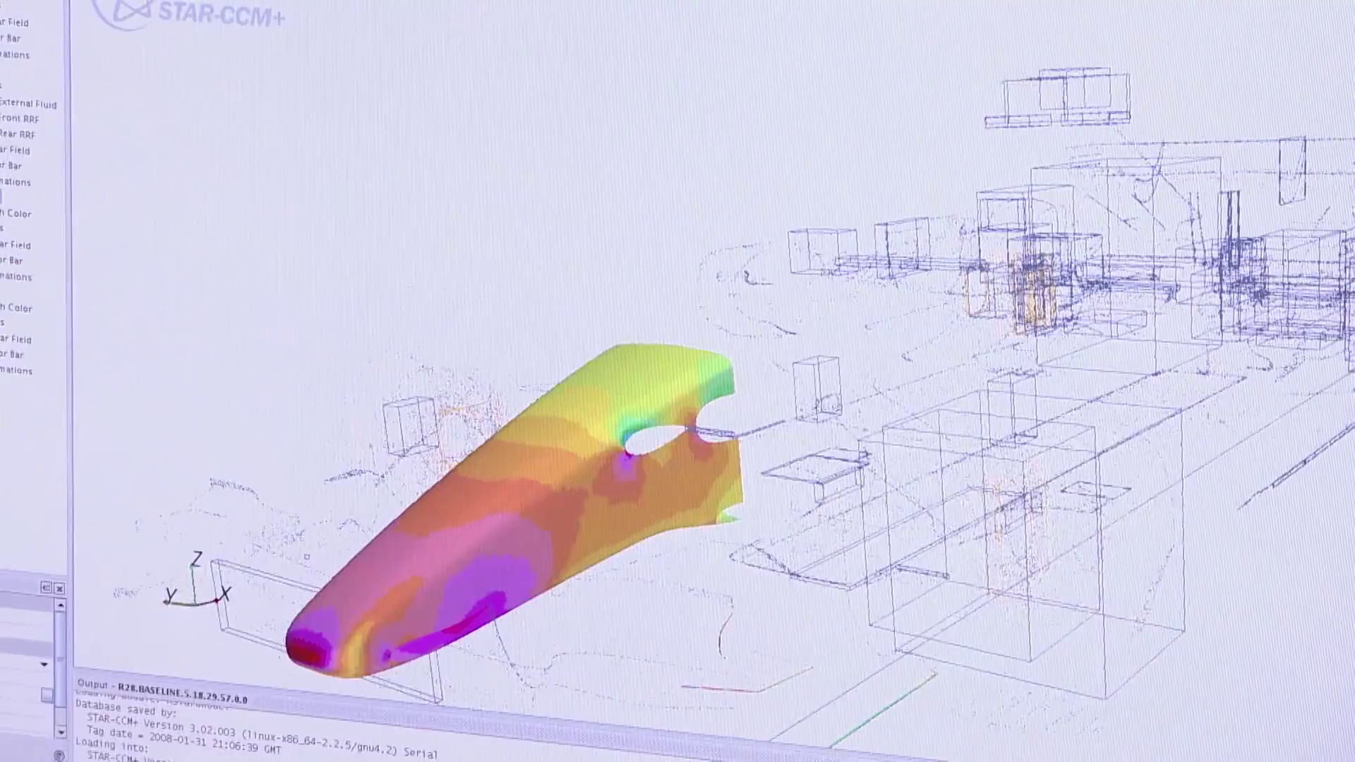

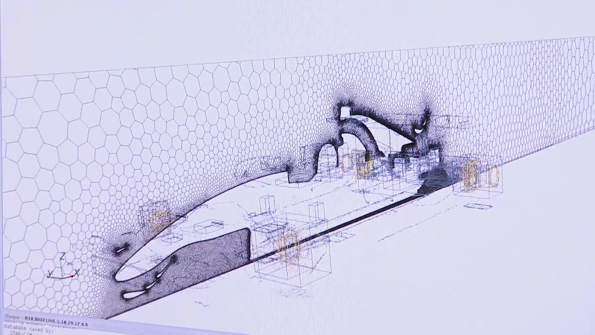

Some random CFD screen grabs featuring Lotus' CFD visualizations...
Software: Star-CCM+ (CD-adapco)
Model: Renault R28
Pre-processing (mesh generation with hexahedral mesh)
Post-processing (pressure distribution)

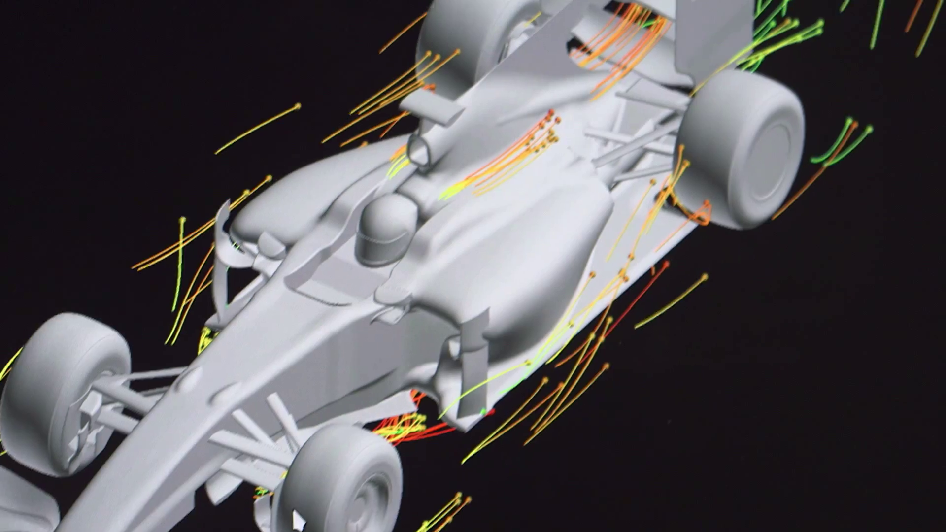

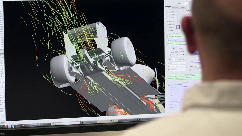

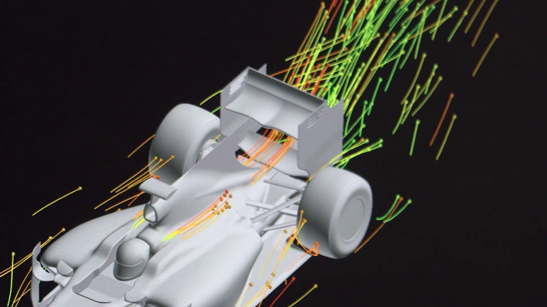

+ streamlines around the Renault R30...
Software: FieldView

Re: CFD - Computational Fluid Dynamics, Motorsport, Formula
There are several interesting things to notice in this picture (e.g converging stramlines under the floor, bargeboard vortices etc..) but I want to pinpoint the reference to "common-flow"
