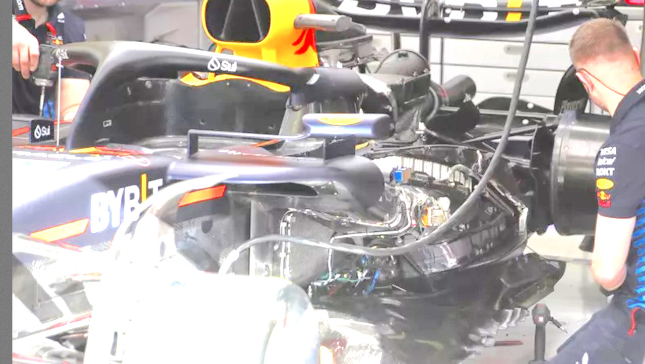

Good overview of the cooling layout:
Small roll hoop fed radiator
V-shaped sidepod radiators
Halo Inlet radiator visible with outlet to the side
via motorsport.com

MtthsMlw wrote:
21 Feb 2024, 23:52
via motorsport.com
Fantastic, +10. That clears up what the should inlets are for. Lightened:
Afaik this is the first time we've seen a ducted louver panel. Typically they open directly into the large volumes under the engine covers.

MtthsMlw wrote:
21 Feb 2024, 23:52
https://cdn.motorsport.com/images/mgl/0 ... etail.webp
via motorsport.com
Good image, looks to have a discrete cooling matrix mounted in the top tube, with it's exit curtailed out through the side slat/vent with no further flow toward rear. Looking like a "vectoring" outlet from aircraft in it's design.
Can't see ultimate detail from that image, but also looks likely the primary radiator located in sidepod may use the latter end of top tube as exit path, aft of that first side exit.

Re: Red Bull RB20
MtthsMlw wrote:
21 Feb 2024, 23:52
via motorsport.com
Have we ever seen a sidepod cooler layout like this before? The inlet diverges into upper and lower radiator flow paths. Correct me if I'm wrong but I don't think I've ever seen it in recent times.

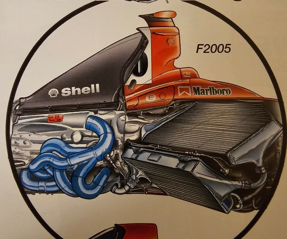

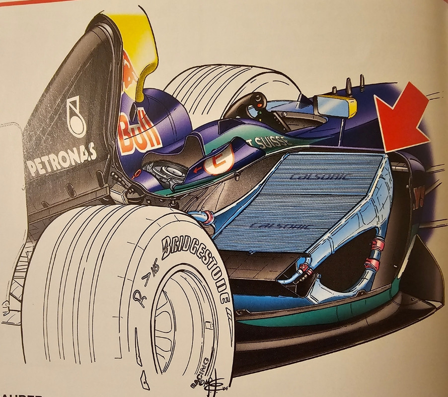

Re: Red Bull RB20
22 Feb 2024, 02:25
MtthsMlw wrote:
21 Feb 2024, 23:52
via motorsport.com
We have. And very often. Sauber and Ferrari introduced it in 2004 and 2005 and this V-shaped layout was the way to make the undercut area bigger and the sidepods smaller in the mid-00s. At least when we talk about the pure arrangement of the radiators in the sidepods.
Just as the Red Bull sidepod concept is more akin to the floor-wing concept of Nicolo's STR06 than a Zeropod concept. The strength of Adrian Newey's influence on Red Bull's design is less innovation than many people might think. It is rather the incredible range of concepts he has studied and seen over his 40+ years and recognizing which ones are performance differentiators under the respective regulations. Thats Neweys real strength. And how these concepts to the benefit of the car as a whole. You can observe this again and again in his career. And that is very clever, because they are already proven concepts, which means less risk. Whether the blown exhaust, copied from the original solution that was intended for the Ferrari F300 (but didn't work because carbon and heat technology were not yet advanced enough in 1998), the monolithic wishbone, first found on the F2001 and which increases the stiffness and decreases weight and parts of the suspension, or now the V-arrangement of the radiators from the 2004/2005 Sauber/Ferrari, which were already used 20 years ago to make the undercut of the sidepods larger. Younger designers are not familiar with these concepts or have no experience with them, whereas Newey has already used them to some extent or at least studied and tested them in the Windtunnel/CFD, and knows precisely about their effectiveness and benefits. And above all, he knows exactly which of these concepts become performance differentiators under which technical/aerodynamic regulations and harmonizes them with the "whole car". This knowledge and understanding is, in my opinion, what makes the difference between someone like Newey and the "modern" engineers and designers who specialize in certain areas but don't know and understand this wealth of concepts and how they fit together with the rest of the car.
