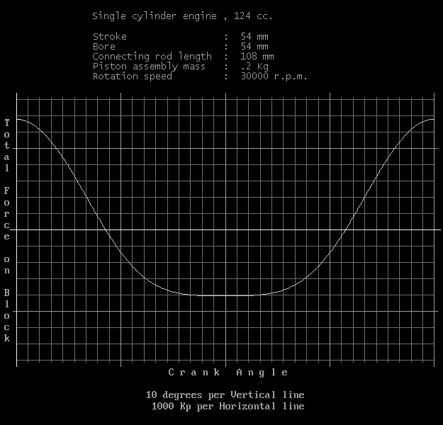

Tell Harry Ryger that 30,000 rpm with 54mm piston stroke is not at all easy, at least according the Laws of Physics.
With 200gr total mass of the reciprocating assembly (including the piston, the piston pin and the upper 1/3 of the connecting rod(s)), it is required an average force of 5.5 tons (12,000lb) acting on the piston from 40 crank degrees before the TDC till 40 crank degrees after the TDC.
http://www.pattakon.com/tempman/Ryger_Force.gif
With only 23cm2 piston surface, in order to decelerate the piston assembly by the pressure into the cylinder, you need an average (not peak, average throughout 80 degrees around the TDC) pressure of 240bar.
By the way, the piston of the 2-stroke Yamaha DT200 (195cc) weighs alone (i.e. without its piston pin and without the upper part of the connecting rod) 200gr.

Thanks Manolis for the nice calculations, but we do made them self too. And mr Ryger knows all about this.
But the goal is not that 30.000rpm, because the max power is between 17-18k.
Beside the princple can go far more than 30k that is a typical Ryger property, which is completely different with the current 2t principle we already used for more than 100 years.
So today 2stroke laws you can forget for a very big part, if it is about tuning, with the Ryger engine it starts all over again.
The mechanical construction determine what is the maximum possible. So see that 30k more as a test that the engine can handle it.

Tell Harry Ryger that after applying for a patent, the inventor can reveal to the public his “patent pending” (which means “protected if a patent will eventually be granted”) invention without risk.
I understand the “secrecy” as a way to spark the fantasy of the potential customers and investors. But after a point, it turns negative and spoils the picture.
If the power drops after 18,000rpm (70bhp at 18,000rpm means a torque of 27.5Nm, i.e. 220Nm/lt) what is the advantage of “can go far more than 30k”?
54mm stroke at 18,000rpm means a mean piston speed of 32.4m/sec.

manolis wrote: Hello LucF
Why do you think you are the only one to know this?
manolis wrote: If the power drops after 18,000rpm (70bhp at 18,000rpm means a torque of 27.5Nm, i.e. 220Nm/lt) what is the advantage of “can go far more than 30k”?
Read again what I wrote before?
