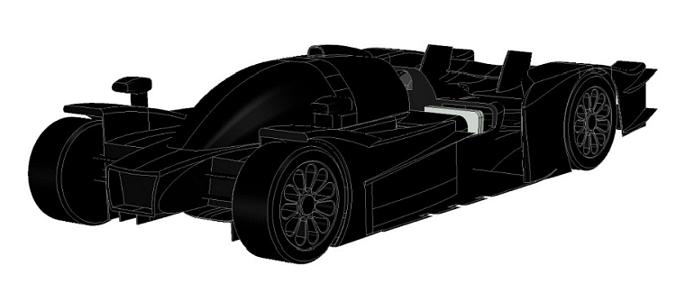

This time I'm a little late. I did only 9 simulations (and 2 of them were focused on a new concept for the diffuser, without success). This is a stolen picture of the in the pits during testing.
I am quite happy with the numbers, considering that, after adding the new wings to the old car, I decided to refine it one more time (the last) despite it is old and beaten.
I hope to see stolen pictures of the other cars too :D
LVDH
47
Joined: 31 Mar 2015, 14:23
Re: [MVRC] Mantium Virtual Racecar Challenge 2018
Interesting rear wing mounts. Looks like you are squeezing every bit of downforce out of it. This means you are not having any trouble in front?
