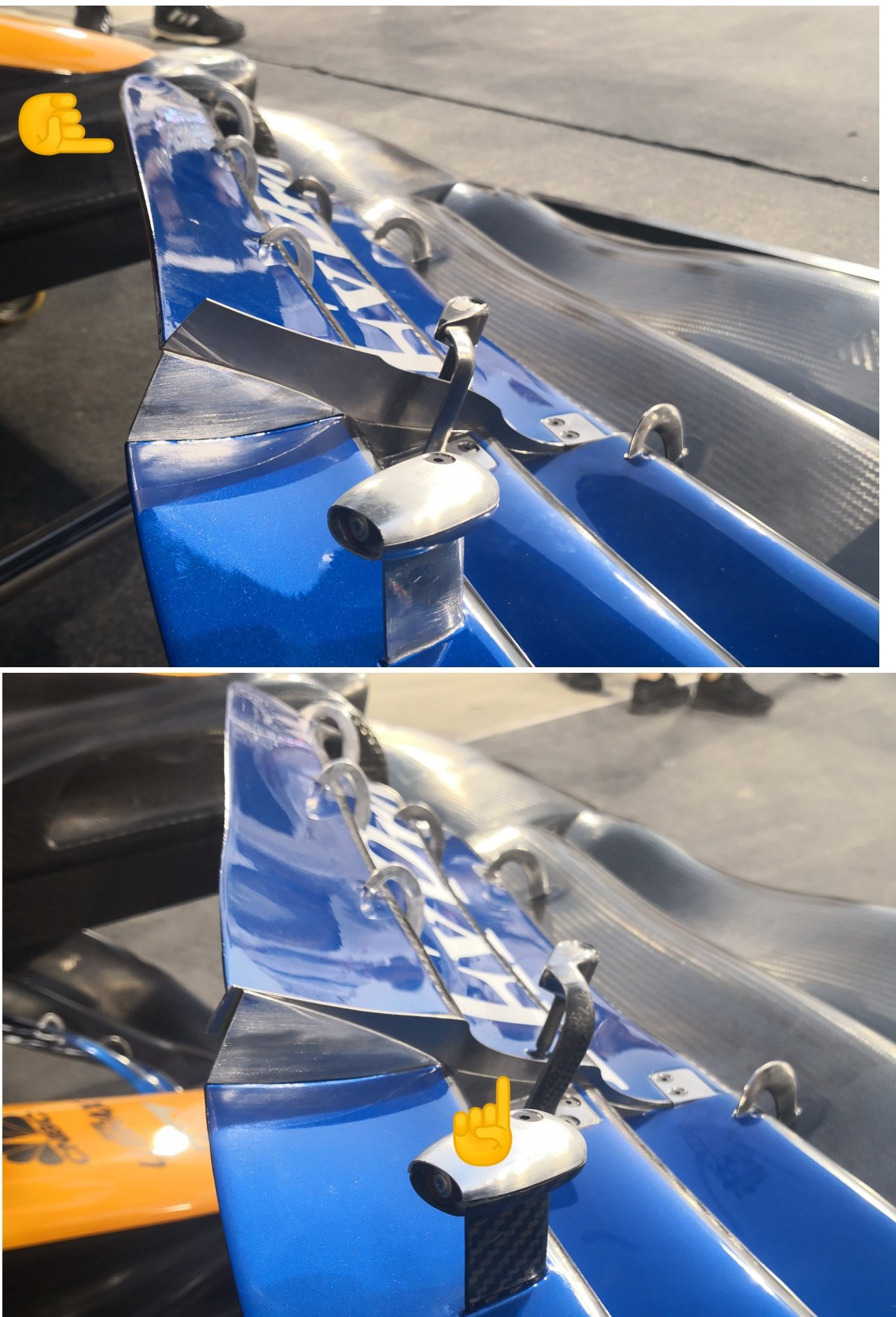

Another difference is the metal vertical parts that close the gap between the non adjustable outer section and the adjustable inner section are placed differently where the metal part meets the adjustable inner section of the wing.
The wing in the lower picture will be able to be adjusted upwards far more than in the top picture before there is any separation of the two vertical metal tabs.
It seems that this was done to create more downforce as maybe they were running out of adjustment on their front wing previously.
