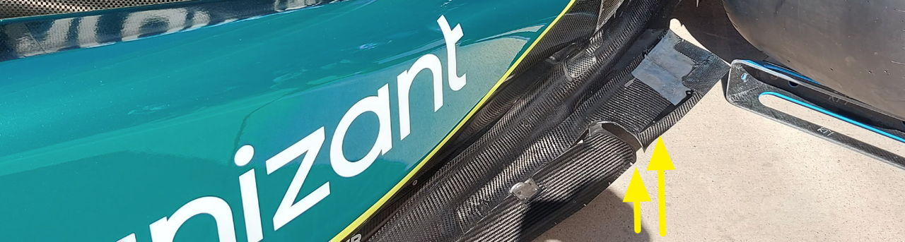

The floor edge winglet (from Kyle.engineer's video) seems to have been removed. The cutout at the back is still there but the winglet is gone.
https://i.imgur.com/wRELSth.png
Top bodywork looks to be similar as last races.
It might have been merged with the new suspended floor edge?
https://i.postimg.cc/cLxtCnCH/image.png
It does state in the upgrade list that the floor edge wing previously under the floor is no longer there
https://i.imgur.com/XseyIx1.png
ah right that's the legality thing.

View of new sidepod, floor edge, engine cover regions from slightly further away
Giorgio Piola 📸
https://cdn-8.motorsport.com/images/mgl ... ech-1.webp
The Kickout is gone!!!!!!!!!!
Yessir the zoomed image of this area from Fabrega posted by KimiRai best illustrates this change. IMO it seems like quite a dramatic change late in the season. Their direction over the winter I'd imagine

Diffuser winglet hasn't appeared. Has it been scrapped altogether?
Egresi Tamás
Egresi Tamás
Joined: 20 Nov 2014, 14:45
Re: Aston Martin AMR23
KimiRai wrote:
20 Oct 2023, 19:20
Yes!

Where the floor meets the mid section.

It's a very unique floor edge. It starts above the floor and finishes underneath.
20 Oct 2023, 20:59
McLaren ran something pretty much exactly like this as early as 2022 Barcelona

Change of concept ahead of 2024. An italian website said it wasn't the last modification, though it's likely the last "major" one.
