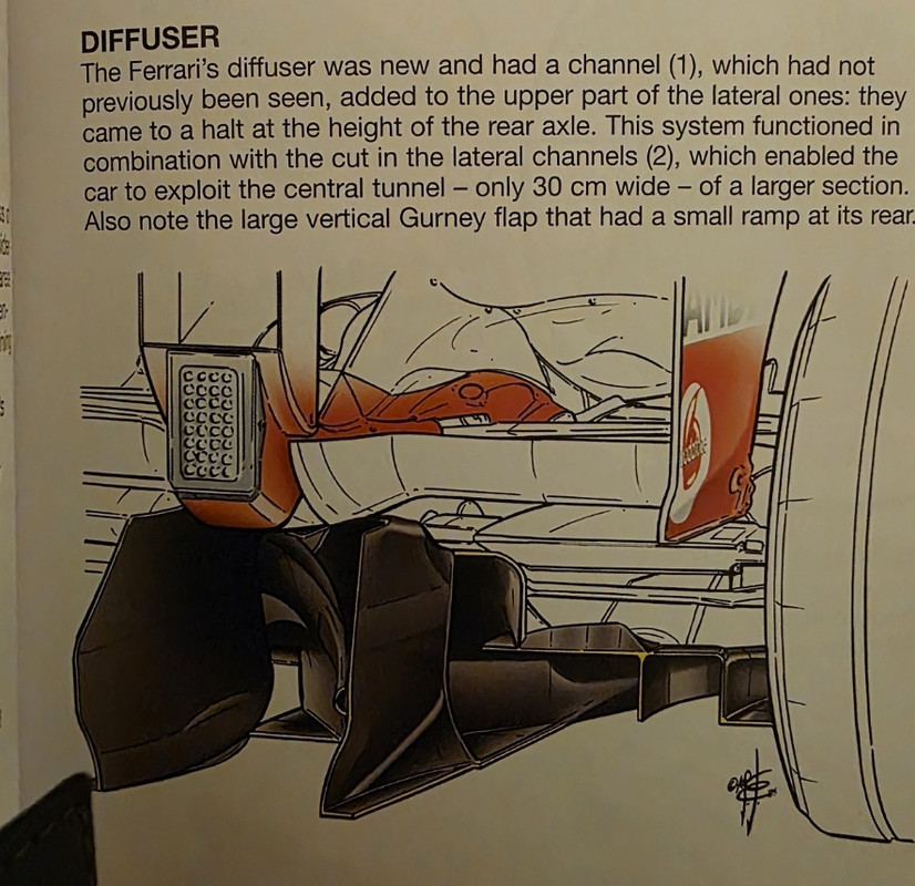

Actually Newey did not even invent the Red Bulls Blown-Diffuser. It was basically a copy of Ferraris intended diffuser for 1998. Unfortunately Carbon and heat-protecting was not at the level at that time to make it work, so Rory Byrne came up with the Periscope-Exhaust, but the famous first Blown-Diffuser Newey used at Red Bull was actually an almost 1-1 copy of this system.
High noses: Harvey Postlethwaite and Jean-Claude Migeot in 1990 for Tyrell
Blown diffusers: Jean-Claude Migeot in 1982 for Renault (also when they debuted pnuematic valve springs)
Active Suspenion: Peter Wright for Lotus in 1983 based on road cars that had it in 1981. The Williams system was derived from an ambulance self leveling system refined by Frank Dernie and Paddy Lowe
Venturi floors: Tony Rudd, Peter Wright, Shawn Buckley, and Martin Ogilvie. 1977 for Lotus.
Outwash front wings: unknown. Frank Dernie is on record saying they took the idea from Champ Car
Underfloor strakes like you see on the current cars: developed by Reynard for Champ Car. Appeared in the mid 1990s. Likely Malcolm Oastler and Bruce Ashmore.
Jim Hall and his cadre of GM engineers have to get big credit. They really beat everyone to the punch.
Double diffuser: some argue Rory Byrne in 1998. On the Brawn, Saneyuki Minegawa
Carbon brakes: Gordan Murray after seeing the BF Goodrich, Dunlop licensed designed ones on the Concorde. Done in consultation with Dunlop.
Carbon monocoque: Hercules Aerospace / Steve Nichols in conjunction with John Barnard. 1981
etc.
etc.
Double Diffuser Rory Byrne 1998 is not quite right. It was 2005, but it was far less efficient because a) the "holes" were missing and b) it was attached to the side of the central diffuser, not above it. However, the basic idea was the same, namely to make better use of the central tunnel, which was allowed to be higher in 2005. The 2009 model was a further development of this idea.
