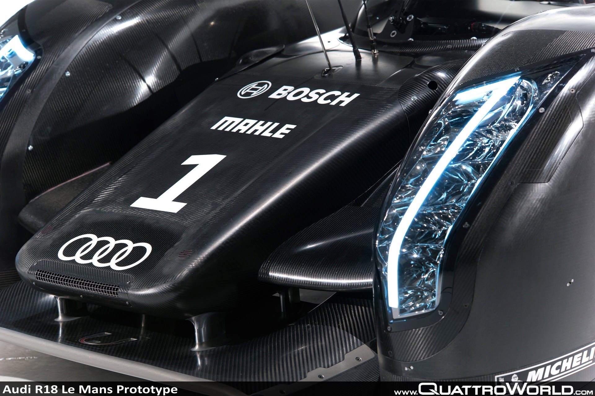

What interresting is is that the cockpit seems wider then on the Peugeot.
On the R15 i believe they ran wider fronts too, but on the R18 they seem to run even wider tires.
Also the tub seems pretty similair with the nose being slightly lower, the overal front aerodynamics dont really differ that much from the R15 plus.
Personally I stil have huge doubts to this car, though the body work is lowered significantly its frontal area seems way bigger and also there is an point through the nose and the wheel arches where they almost hit each other. I'd rather think this car is based on Ameican tracks with its weird balance and tire setup. The ARX-02a was an similair car which just was purely made for the ALMS.

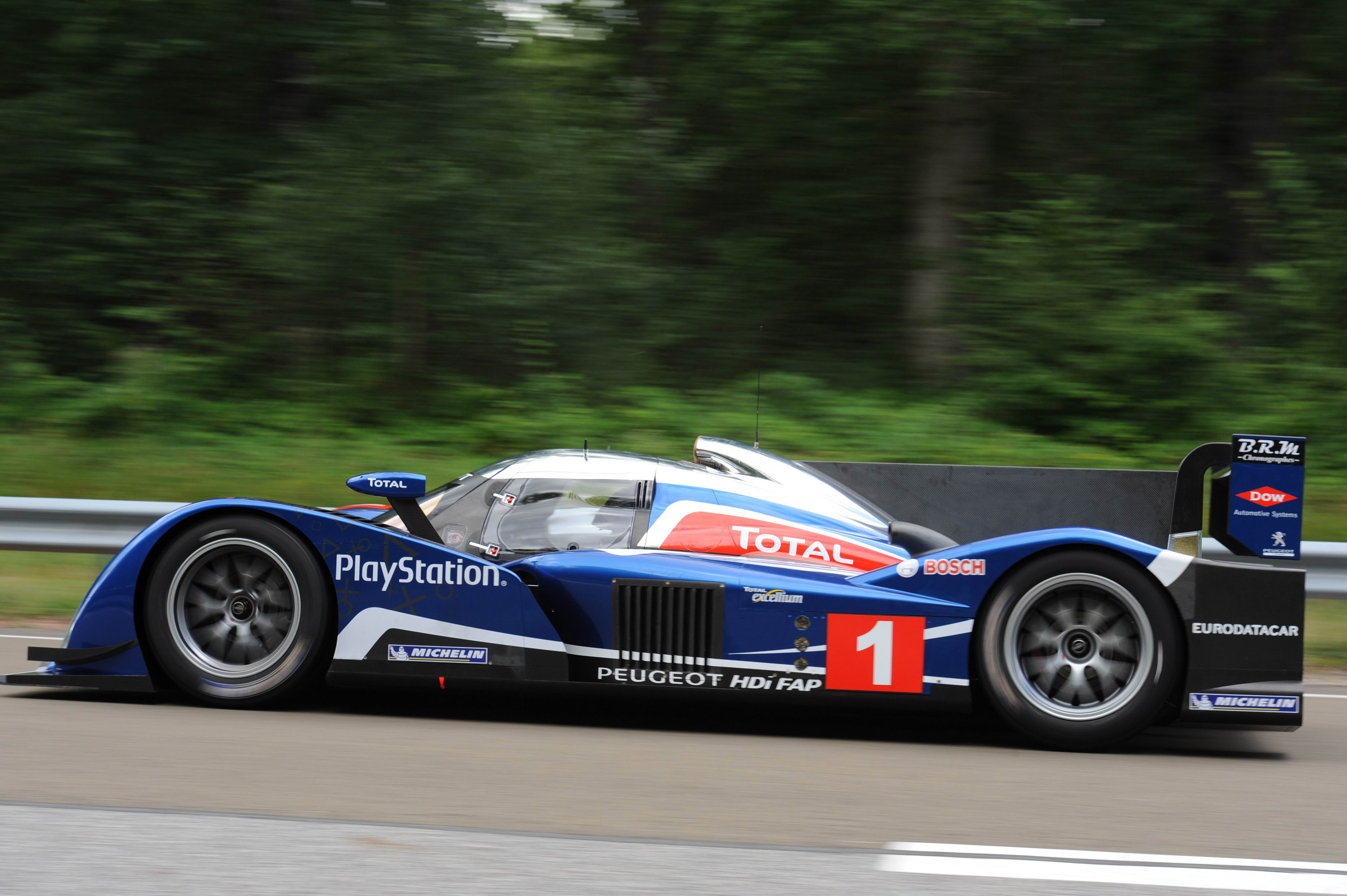

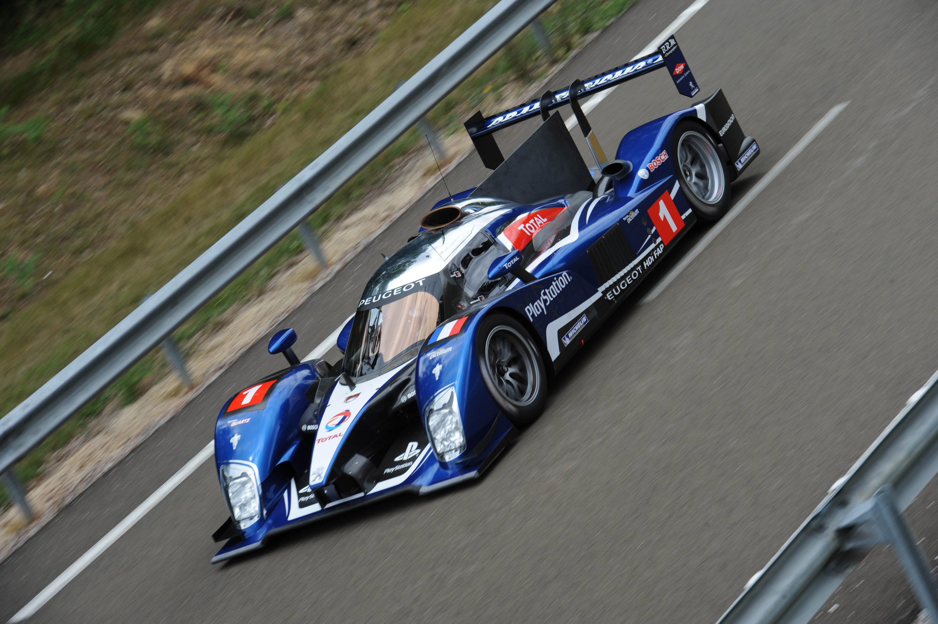

High res shots of the 90X (right click on image, then view image in Firefox):
Detail of R18 front diffuser (splitter) tunnel, front inlet and recessed hinged tow-hook:
No front inlet visible on R15+:

Those pictures of the Peugeot is that the real 90X??? Or is it (as i believe) just a test mule to test out a few new things??
