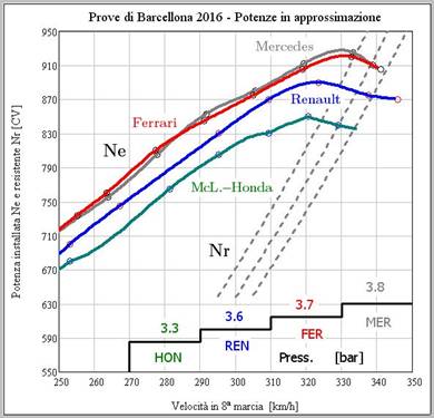

Way, way too many approximations in those graphs. He has his curve models, fits them to measured top speeds (yikes!) and spews "data". No, the cars did not find an extra bar between Montmelo and Monaco. No, power curves are not optimized so that there is more power at 12500rpm than at 10500 rpm. And no, the same curve of power drop cannot apply at different speeds in a fixed gear ratio season (nor does he have any data to fit at 8000rpm in 8th).
Edit: it gets even worse. Which of the power curves in this picture has the same shape as the ones above?
Asnwer: this one!

Good point Hollus. The power curves are way too peaky.

PlatinumZealot wrote:U have to neasure accelerarion in some form to get horsepower so that author has to tell how how he measured acceleration...
The horsepower is just an approximation. In fact it doesn't even matter here, as it would simply stretch or compress the diagram in y-direction. Those diagrams are not power curves, but acceleration curves based on telemetry data! Therefore, talking about rpm is imho wrong in that context. 8th gear simply was used to rule out traction, which would otherwise have a huge influence in an acceleration diagram.

gandharva wrote: The horsepower is just an approximation. In fact it doesn't even matter here, as it would simply stretch or compress the diagram in y-direction. Those diagrams are not power curves, but acceleration curves based on telemetry data! Therefore, talking about rpm is imho wrong in that context. 8th gear simply was used to rule out traction, which would otherwise have a huge influence in an acceleration diagram.
So if I understand you correctly: y axis: acceleration and x axis: velocity. To me this doesn't make sense because acceleration times speed is proportional to power. Ans such a curve would've been even steeper.
Do above cosworth picture really depicts power vs rpm? or is it torque vs rpm? If the latter, then power vs velocity plot makes sense, because the same follows from cosworth graph (torque*rpm).
I think power vs velocity graph has simply been obtained from gps data. I just don't understand why would anybody want to move to 8th gear already at 210-220kph
