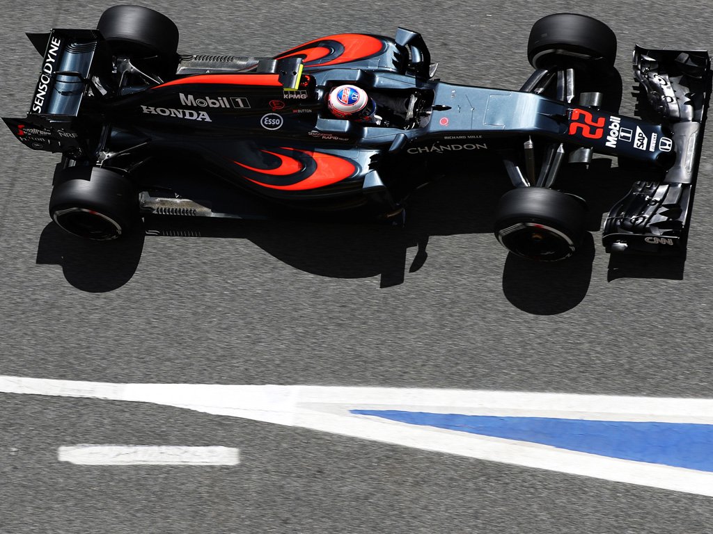

It's not really that different. The underlying philosophy is the same as for instance Red Bull. The added details concerning the inner edges are merely serrations
204
Joined: 23 Feb 2008, 17:55
Re: McLaren MP4-31 Honda
They still run the connected end plate though, a solution that isn't popular anymore since 2014 when everyone moved away from it.
Wing tips don't follow the trend either, everyone has them curling downwards.
That is pretty much the solution everyone runs, apart from McLaren.

The "Window" in the FW Endplate is huge:

Isnt that strange adjuster disrupting the air flow?
247
the one with the green flow vis is Spain.
Clearly the narrowing starts closer to the front and is more pronounced.
An almost rectangular hole at the back (Triagular before).
Lower hole (start below the upper suspension arm).

The bottom of that rear wing still looks like it can hold a latte. Anybody understand why the front is almost level with the back? I presumed it was for less downforce but I'm not sure any more...
LOL, maybe they need to run more rake ???
Here is a better shot .... Thunder's a slacker on the pics ;)... Or is is it "Thunder only happens when it's raining?"
