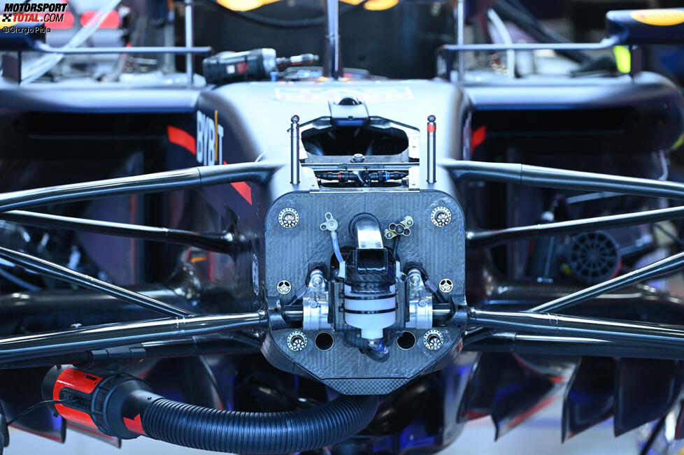

Some detail photos from Motorsport.com
1143
