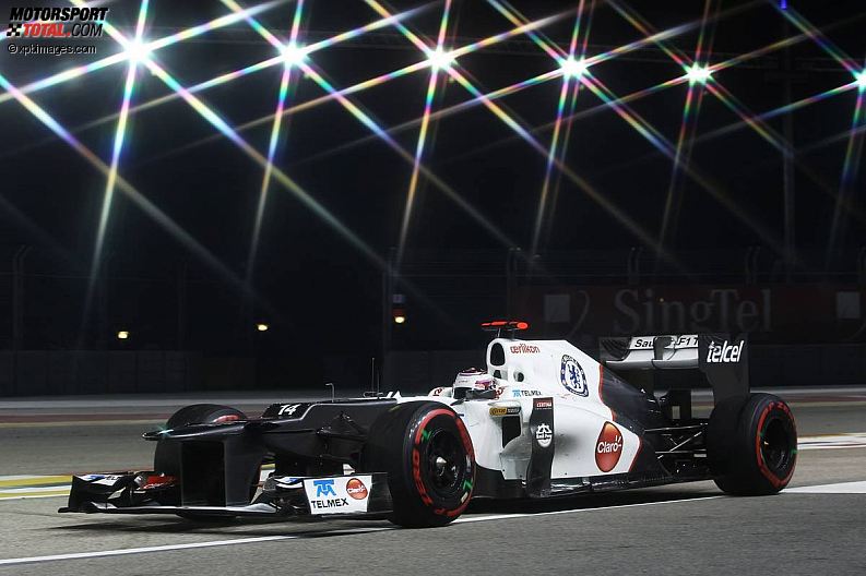

BOK
BOK
Joined: 07 Oct 2012, 17:34
Re: Sauber C31 Ferrari
Singapore
Japan
Huntresa
Huntresa
54
Joined: 03 Dec 2011, 11:33
Stranged that we missed this!
raymondu999
54
Joined: 04 Feb 2010, 07:31
Perhaps the ramp solution actually is providing more downforce overall, but more drag?
(I say more drag because they've used the ramp in Singapore and Suzuka - two high downforce tracks, while Monza was still (to my eye) the exhaust bulge)
