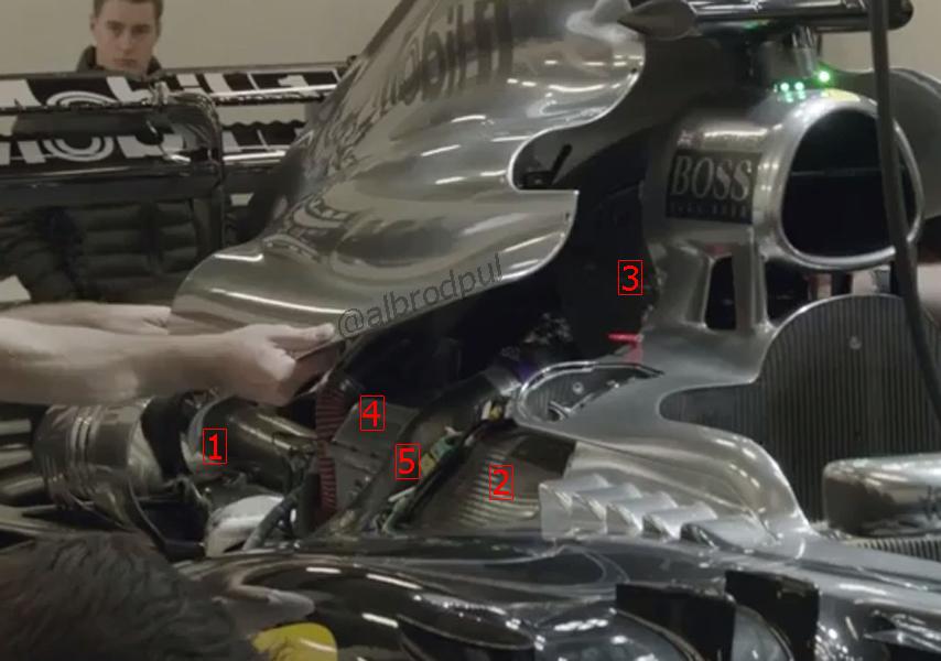

1Escape
2 Combustible
3 Entrada aire intercooler
4 ICE
5 Tubería de radiador a intercooler

Egresi Tamás wrote:1Escape
2 Combustible
4 ICE
https://pbs.twimg.com/media/B3MrusbCAAEr4LX.jpg:large
The enigine is air to air intercooled as well.
