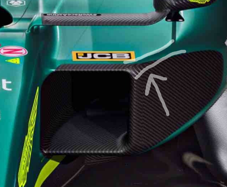

It's a bit hard to see on the limited set of pictures we have so far, but doesn't it look like a sort of opening where the diffusor steps up? Theres an odd joint/assembly there and I can't tell if there's a kind of Naka duct there or else, I guess not but it looks odd.

JordanMugen wrote:
Thu Feb 10, 2022 5:02 pm
timbo wrote:
Thu Feb 10, 2022 3:37 pm
Are there minimum radius rules for the sidepods? The transition from the flat panel to the rest of the sidepod is quite sharp.
Yes. What flat panel do you mean?
I don't think the minimum radius rule applies to the junction of the floor and the sidepod.
The flat area right next to the intakes.

Mat-tes wrote:
Thu Feb 10, 2022 5:32 pm
https://ibb.co/GW68Vg8
That is quite a sharp turn below the undercut, I wonder how much air they can turn with that sort of shape.
