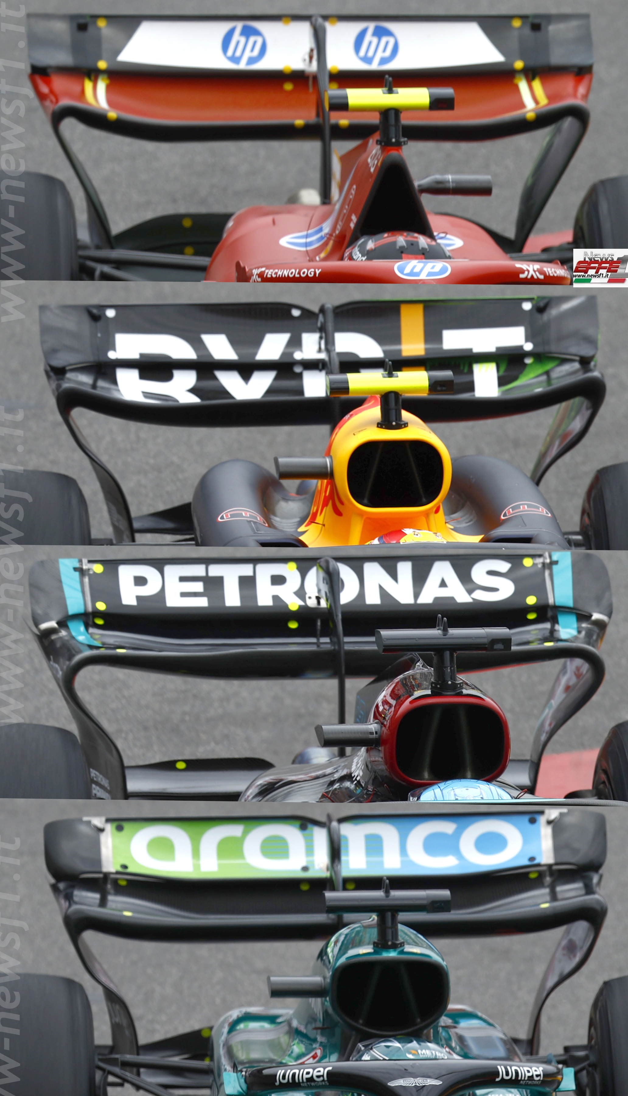

Rear Wing comparison Image
1087
Joined: Thu Jun 07, 2012 4:00 pm
Re: Ferrari SF-24
zioture wrote:
Fri May 24, 2024 4:21 pm
Rear Wing comparison https://pbs.twimg.com/media/GOWoX74XEAA ... =4096x4096
Probably not the perfect topic, but i would love a comparison between the RBR triangular edge(almost trying to be an endplate) and the Mercedes very round version(with Ferrari in between, a little bit closer to RBR)
