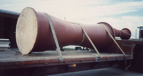

Location: Cape Town
Re: Intake Valve and Feliks' ideas
I designed a steam venturi to heat & eject a carcinogenic gas. It was extremely small as there was little of that troublesome tailgas. Those vast ones by Croll-Reynolds are very interesting. The design guide I had placed the steam nozzle much deeper into the inlet.
Big problem with my one was the tailgas was at -40°C & I had not realised that the condensing steam would form droplets which fell to the ground bringing the dissolved carcinogen exactly where it should not have been (I was aware of the wetness of the mixture but assumed it would remain as a vapour). I left that company just then (not as a consequence) so I don't know if increasing the steam flow solved the problem.
