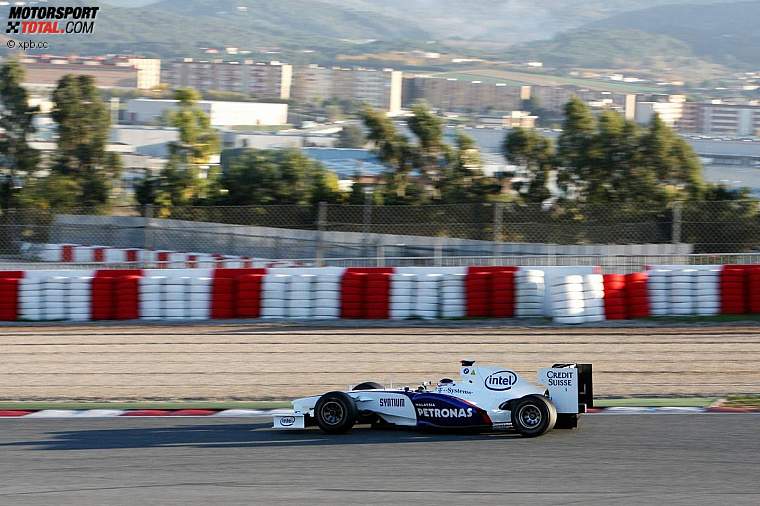

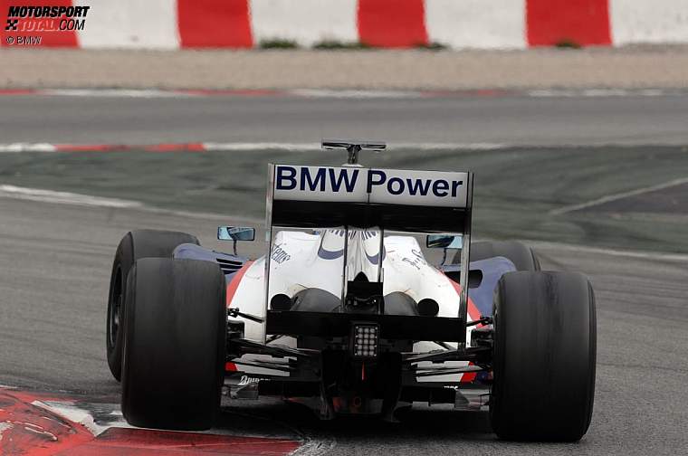

wesley123 wrote: The car looks legal to me
But it isn't. There are quite some details which don't comply with 09 regs.
- gills on the left side pod
- a quite big hole on the right side pod
- three-element rear wing
- the diffuser should not have a big mid channel and should only start at the rear wheel center line and should extend to beyond the rear wheels (so it should be visible from the side)
So really, that car is not legal according the rules of 09. But i think it's safe to say BMW knows that. No reason to panic.

Or maybe the 08 diffuser on that car just doesn't work nearly as good as it did with all the turning vanes and barge boards around the splitter?
It's all just assumptions. They'll neither run that diffuser nor that rear wing because they are both not allowed.

wesley123 wrote:
wrigs wrote:That is possibly because they are still running what is in essence a F1.08 chassis with some new parts on it. Someone here noted that the diffuser didn't look quite legal for 2009 and that the rear wing had three elements which isn't legal either.
So even though it looks very different from the normal F1.08, it isn't the complete 2009 car.
The car looks legal to me, ever heard of loopholes?
Why should they make a new rear wing now wich isnt even allowed?
The car we see now is an undeveloped F1.09, everything is within the rules on the car, and it would be useless if they change everything on the car only to test it and then they still have to design a tub and redesign all those parts on the car because they dont fit on the new monocoque?
Im telling you, the car BMW is driving now is an undevelopped F1.09.
Look, I'm not a BMW-engineer, but the fact of the matter is that that car is an F1.08 with a lot of new bits on it. It might look a lot different, but underneath the skin that's an F1.08 chassis and that's the main difference. Like someone else said it also has cooling vents, which seems to suggest that BMW doesn't even have their cooling system thought out for 2009 - and to be honest I think there are several other things they haven't thought out regarding 2009 yet.
If BMW had been testing their F1.09 parts on a brand new chassis then trust me we would have seen a lot of headlines about it. It's not an undeveloped F1.09, it's a 2008-2009 hybrid.
