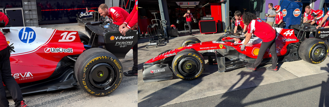

The Barcelona spec (image Brahmal posted above) does look different to what theyve ran at previous circuits imo. these are the best images i could find of it, left is China, right is Australia to compare it to the image Brahmal posted above. From the way AR and The-Race are talking about it, it doesnt seem like its just a circuit specific upgrade as the fia doesnt allow them to bring rims for specific circuits.

Brahmal wrote:
16 Jun 2026, 19:36
New wheels for better heat management. Apparently just the rears, though I’m not certain on that.
All four wheels according to The Race.
