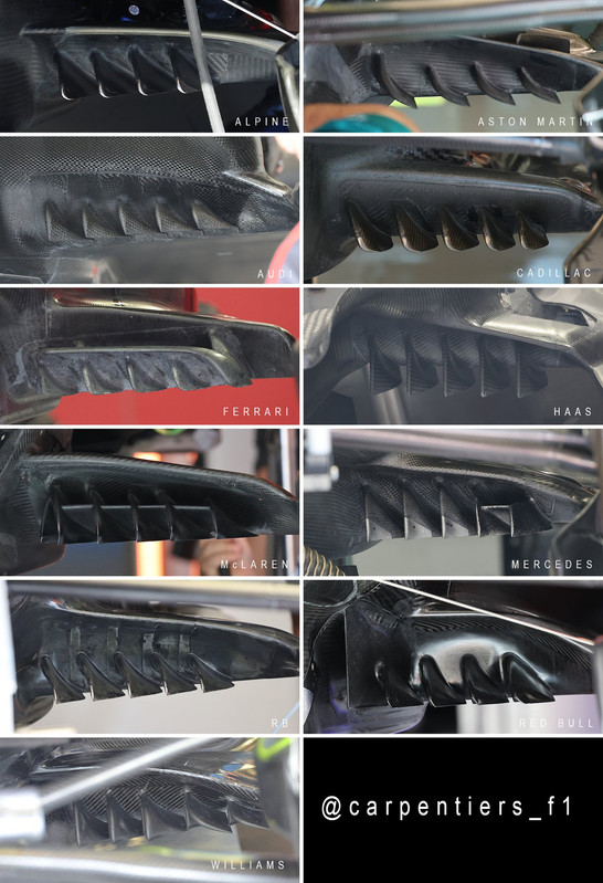

bananapeel23 wrote:
16 Jun 2026, 08:07
I’m so curious how those two layer daggers work. Is it just like a multi-element wing in that it can get better airflow attachment with a higher AOA by stacking elements?
I think so, reducing airflow separation and turbulence at the floor's leading edge would definitely be a good thing. McLaren seem to be following Ferrari in this. OTOH Red Bull and Audi in particular have much more sculpted claws that will turn the airflow much harder, so two different philosophies in this area seem to be emerging.
