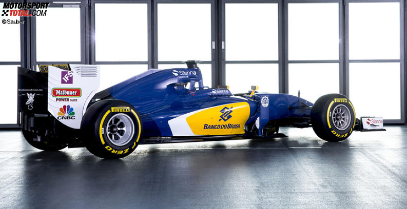

Interesting rear wing pylon

But where is the rear pullrod? http://f1.f-e-n.net/index.php/url154961

Damn, blackout, that screenshot is taking awfully a lot to load :lol: .
Strange to see a team still going for the double pylon support at the back.

And also the air box behind the driver head seems to curve down a bit rearwards than normal, no? it seem sot suggest that in fact the ferrari plenum starts a bit rearwards and that there is something in the space between the engine and the seat. Oilbox? intercooler? I don't remember but I think there were several rumours about it

Bulky looking sidepods. But then the air inlet area behind the drivers head is massivly undercut. Also very interesting rear suspension. Tiny front brake ducts.

The front suspension wishbone arrangement looks to be lowered compared to last year [lower roll center?], looking quite similar to Toro Rosso, Mercedes, etc. My observation anyway.

I believe so also. Even if it's just by a small amount. Steering arm is still up though.

Wonder why they use the front wing they abandoned mid-season last year as launch spec

Interesting that the flow conditioners around the leading edge of the upper sidepod (I'm sure there's a more elegant way to describe that, but I'm sleep deprived!!) stop roughly level with the top of the sidepod entrance. I haven't noticed this on any other cars - is this unique to Sauber or have I just not noticed the others?
