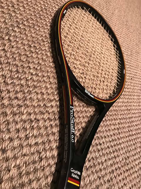

FW17
185
Joined: 06 Jan 2010, 10:56
Re: HALO Approved for 2018
I am not sure if a grid or a vertical grid only would affect vision.
