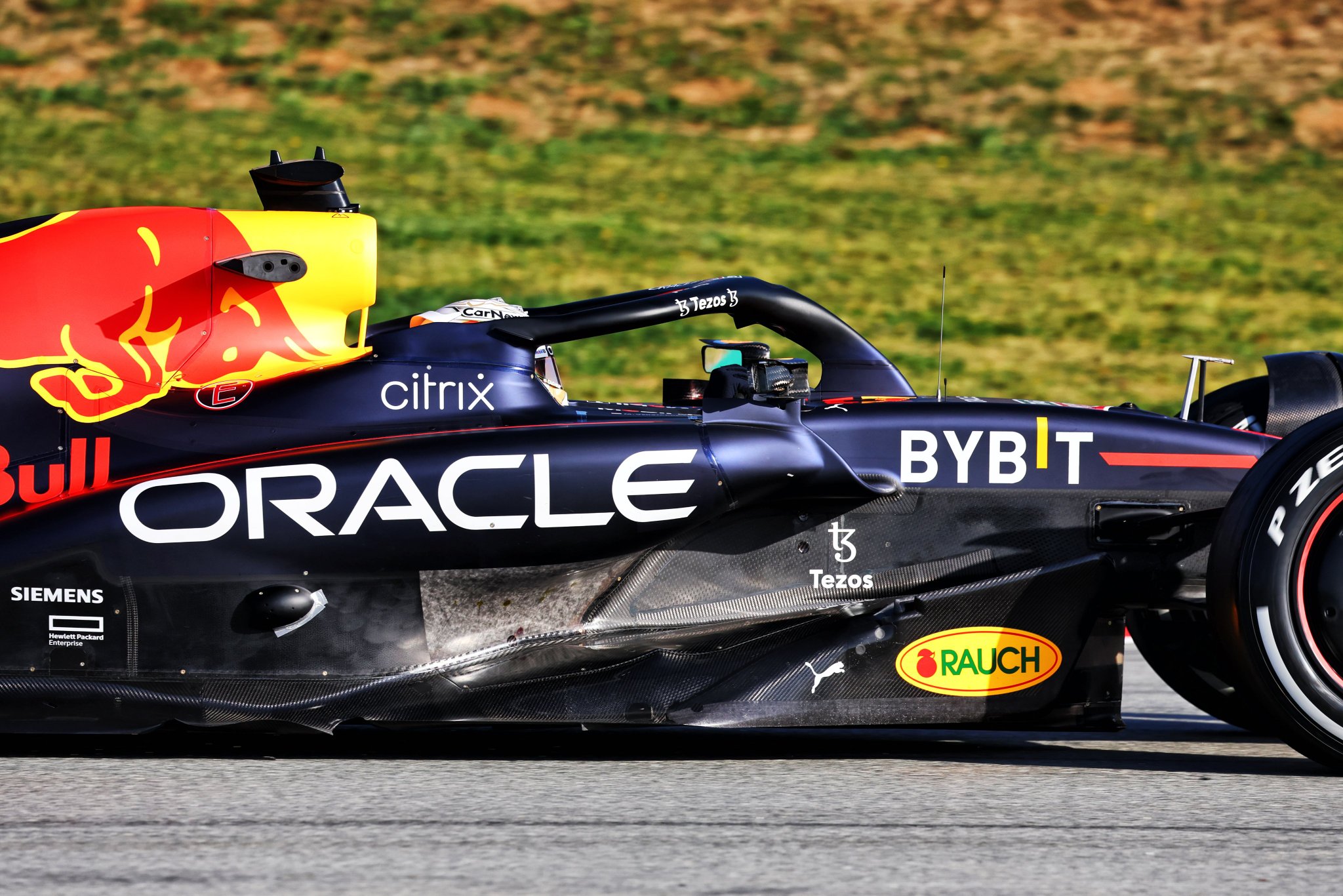

Interesting halo winglets. The larger of the two leads to the wavy side-on view. Clearly a developed area

Can see the suspension elements
