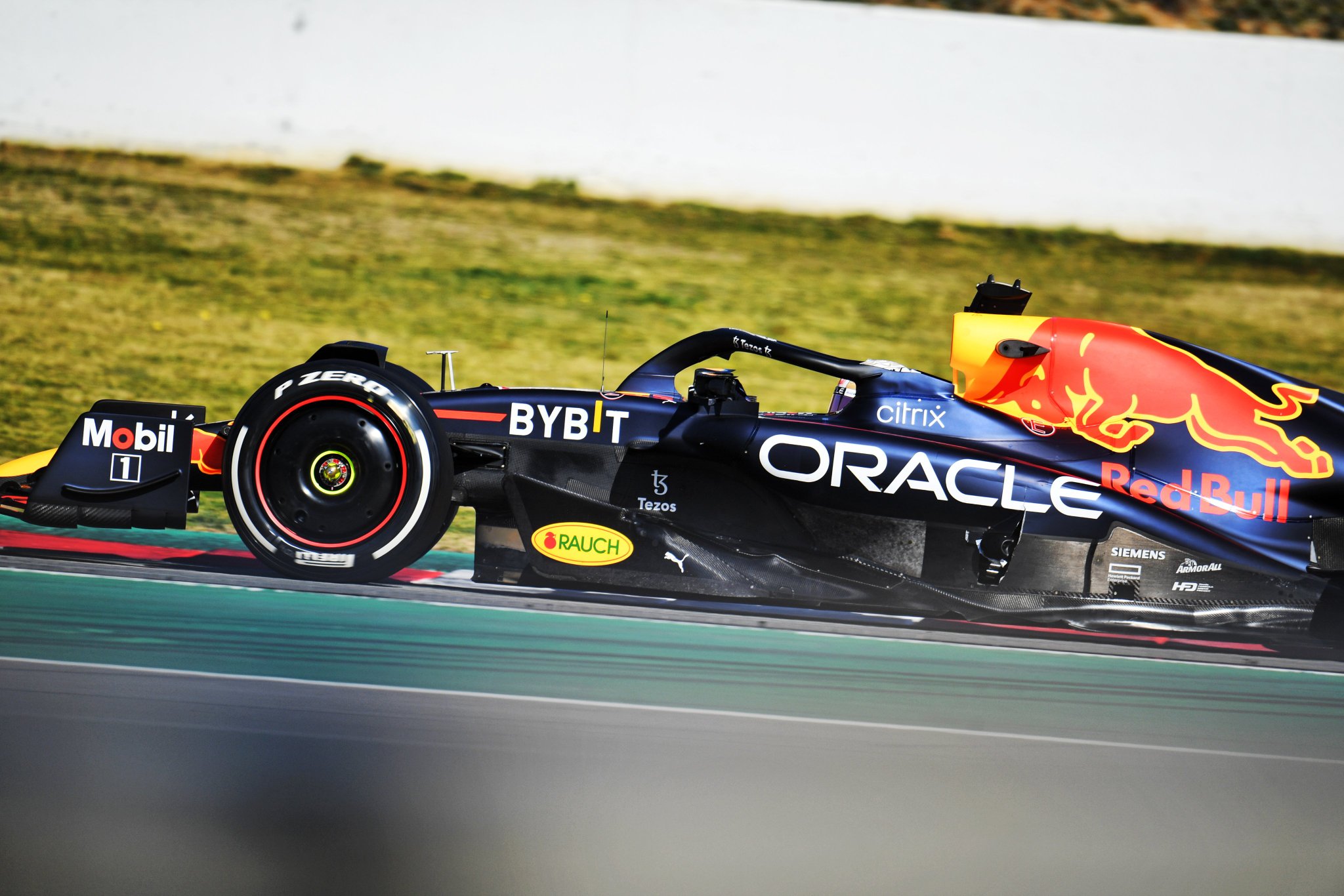

Those top suspension arms certainly look like they are multi-link.

Looking at the non finished panels of the side pods, with the ‘spicey “update remark, could Newey have some kind of blown diffuser variant in his bag ? As he was always experimenting with these items.

Do the wishbone have pivot point at all or is it flexing carbon nowadays?

Generally flextures for almost everything bar the front steering/hub joints

Looks like one of the sensor pods ripped off and they put some tape over it

Looks cracked a the "L" from ORACLE.

ojir19 wrote:
23 Feb 2022, 12:21
Varusi_12 wrote:
23 Feb 2022, 12:19
https://uploads.tapatalk-cdn.com/202202 ... 7e439f.jpg
Red: Lower suspension arms
Green: Steering arm
Yellow: Pull rod
Blue: Strange upper suspension arms??
Can anyone explain the blue ones?
https://i.postimg.cc/4xSg9fgt/rb18-drs- ... 170725.jpg
You mean strange because they differ in height? This is an anti-dive geometry. When breaking the car does not "dive". Ferrari also has an anti-dive front suspension, but less anti-dive.

https://i.imgur.com/1dYYC5q.jpeg
I guess it was damaged when he went off track? but we saw no footage of him colliding with anything today. just Gravel.

Maybe, it's difficult to judge unless we get to know when the photo of the damage was taken.

I think the outer skin is so thin that the drag on the camera mounted there has caused it to break at the rear plate of where the camera is sitting on.
I guess we can call that good news :D
