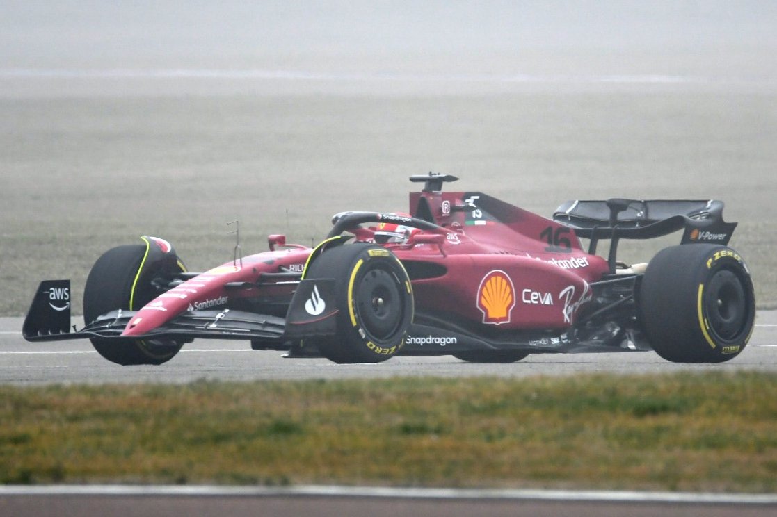

Ferrari is very interesting. The side pods are very down wash near the body, but they look to be using airflow through the outer (bulbous) part of the pod for something very new (in F1, AFAIK).
There is an exhaust to this part where the rear suspension intersects the bodywork; I would say that they are using through-flow to enhance the rear aero (i.e. there is no cooler in the outer part of the pod), the cooling package is tight into the centre (alongside the chassis) and is exhausted through the upper vents); because of the bulbous outer part of the side-pod, the vented air will be largely constrained in where it flows to (much more so than the AM).
Of course, this could be total hog-wash, but so far we are seeing different solutions on every car! Pinch me, I must be dreaming!!

In Fiorano
