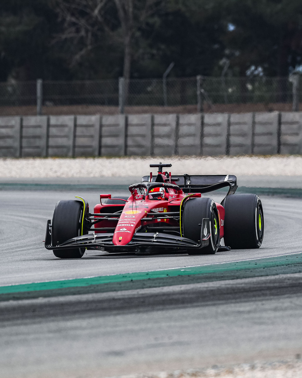

Could the floor change be about addressing the porpoising? there was a rumour the Alpine did a floor cutout for this reason. OR maybe an Aero person can comment on the potential performance gain Aero wise on that detail?

There's lots of talk about teams trying to get the edge of the floor to flex down, this is probably to do with that

Are they using those squares to check the floor for flex?

Yes. You want precise control over the amount of flex there. I've seen on the Haas they already put a supporting bar there.

Notice the inlet to the diffuser is also gone as well.

Seems to be there but hidden behind the tyre blanket
