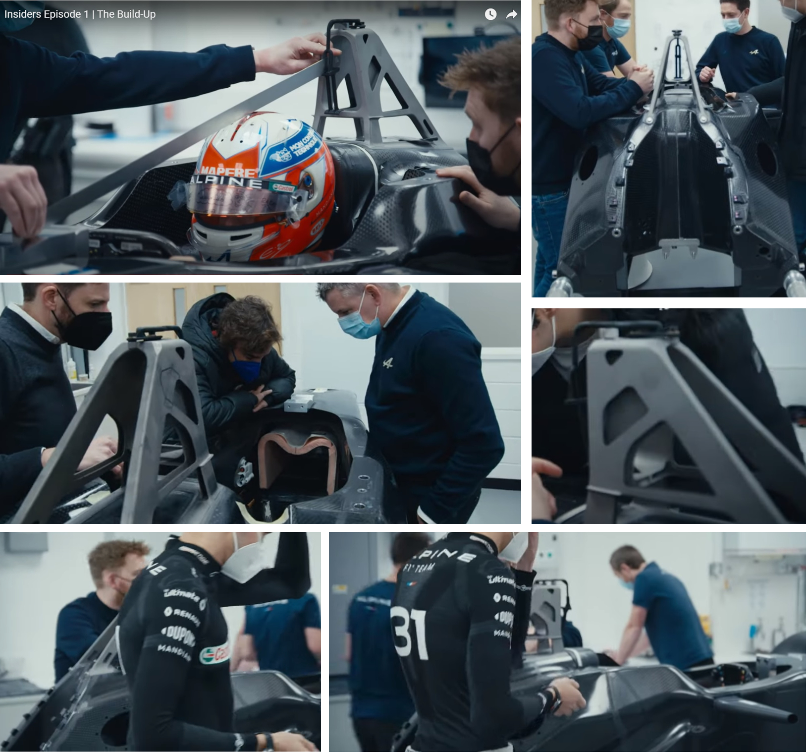

Here a closer look on the monocoque & its metallic (Titanium?) rollhoop which has hollow U-shaped thin structures. Lightness + strength through relatively complex shapes, thx to 3d printing/additive manufacturing.
It's from "Insiders". (6 minutes and still better than DTS)
