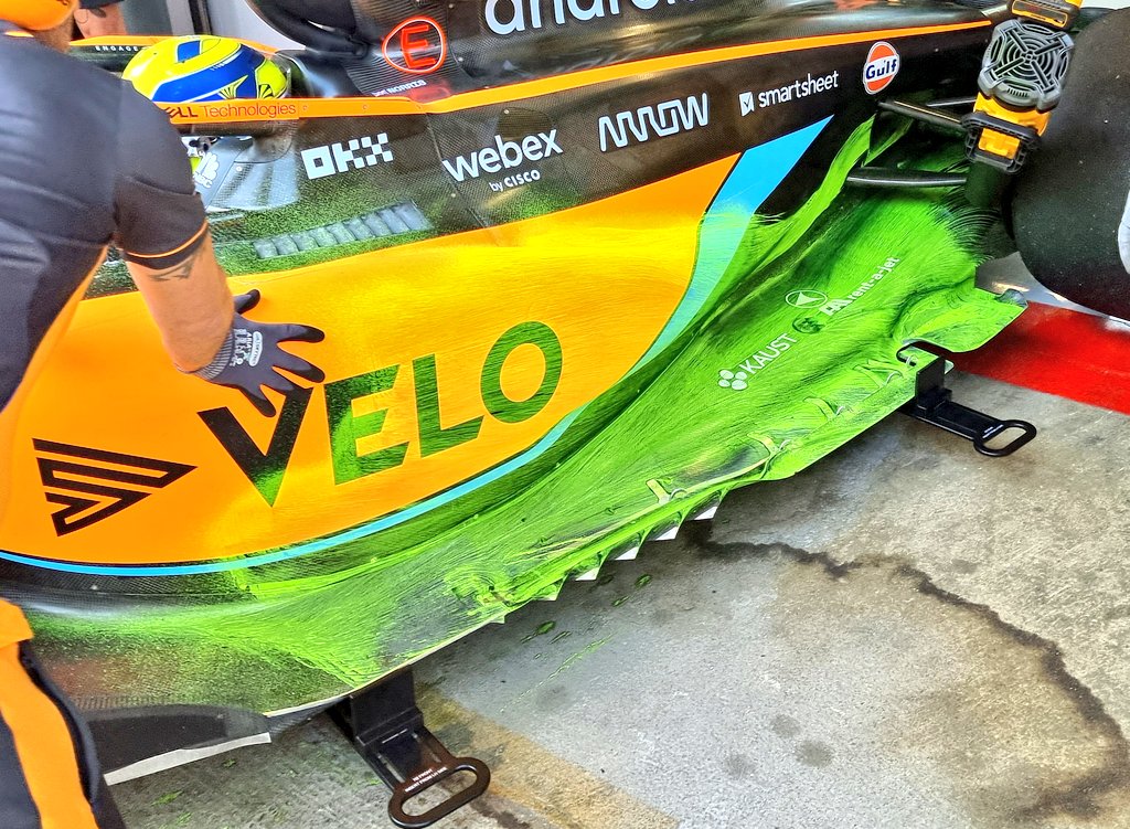

Now McLaren have joined the shaped sidepod club, with halfway house tub-pods (not as wide as Red Bull or Aston Martin or Ferrari or Alfa Romeo or even Alpine or AlphaTauri, but rather an iteration of their existing design):
f1rules wrote:
20 May 2022, 14:49
seem a bit interim between their own and rb, ren etc. They have more of a ramp to help guide the air down the sidepod and the air going around the sidepod is now guided by a tunnel, before it was just one big "open" area like merc. And looking at both rb, renault, ferrari etc, theyre all using the sidepod to guide the air, so seem the right way forward
@AlbertFabrega
https://cdn-1.motorsport.com/images/mgl ... lea-1.webp
Will Williams and Mercedes eventually join the club too? :?:
