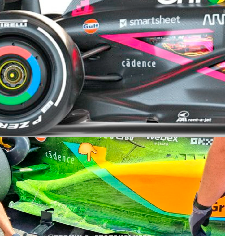

1567
Re: McLaren MCL36
f1rules wrote:
27 Sep 2022, 12:46
> Sidepod design updated, more undercut, interesting if they had to move some of the electronics placed in that area, which was a lot
To where? Dont forget that the reason they have that ultra slim splitter is because they moved all the electronics and stuff, that is usually placed in the splitter, to the sidepods.
The question marks for me are:
- why did they place their cooling components so far forwards?
- why didnt they use Merc's water air intercooler that was designed for this compressor, like the other Merc teams did, and continued with air-air interccolers that are placed so for from the engine?
- why they dont use big undercuts on the monocoque sides like most teams do, and opted for this monolithic monocoque shape instead?
All these points are obviously related, but what's the route cause? probably the monocoque shape..
RB who has the same split-turbo layout and also uses air-air intercoolers did the complete opposite. They did everything to put the coolers as close as possible to the compressor etc.
Regarding the new small undercut under the new extended sidepod lower lips, they hade some empty space there

They may not have had to move much… Their sidepods were still very narrow from a top view perspective, making them wider would create the undercut without the need to move the electronics.

I think what he's seeing is that the sidepod lower front entry section now starts at the same distance forward as the upper part. They've taken that and sculpted it in to a more gradual curve. Plus the new picture's sidepods are wider that the original release sidepods lending itself to looking like a larger undercut. The truth is the under cut is the same, it's the overcut forward and outward(horizontally) that has grown.

Expecting only a couple tenths, even with this package apparently, so might only be a wash with Alpine's upgrades coming too, sounds like it might also be mainly to get the concept in and refined before next year, would tie in with why they're making the new rear wing to test I guess.
