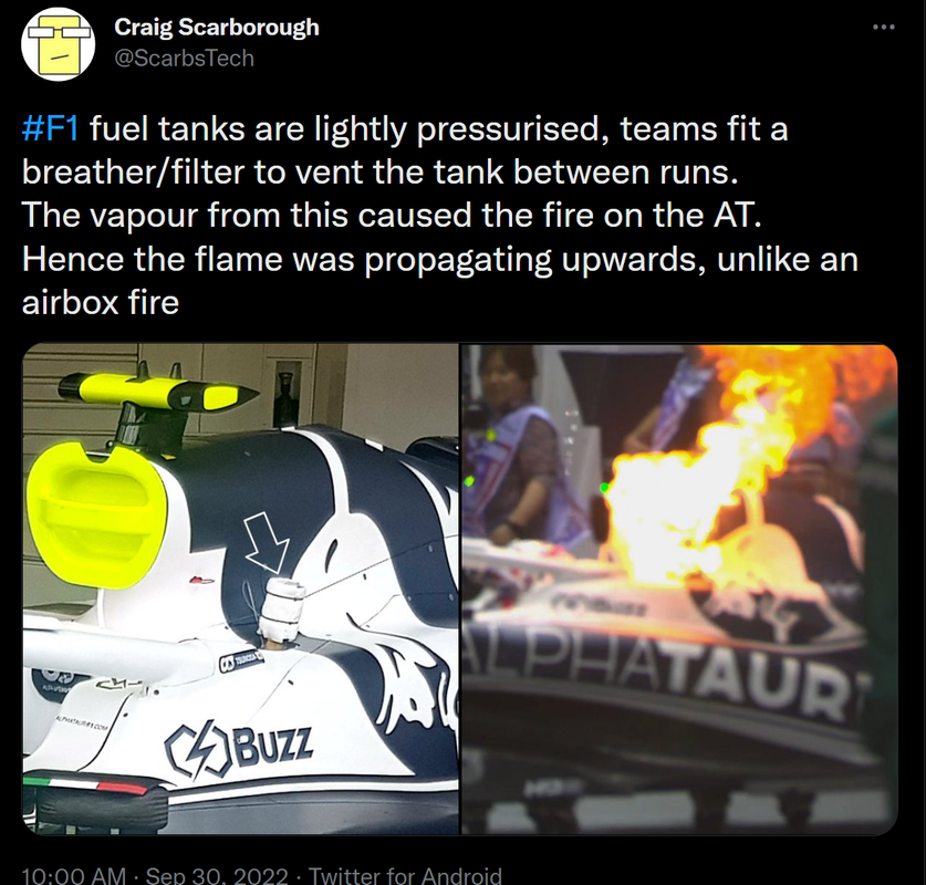

So, what of the Gasly pit fire?
are they running an injector at the turbo inlet?

Pierre also lost a bit of time with a small fire after connecting the fuel breather, which looked worse than it was, and we were able to quickly get the car back out.

johnny comelately wrote:
30 Sep 2022, 21:18
:lol: How would that be even remotely possible under the current technical regulations?
30 Sep 2022, 21:18
Rather than larf like a clown and make things personal, just give an opinion as to why there was a fire, which is quite the complex question at the top of the airbox.
And to be a rules based thinker prevents lateral thinking, so what is your considered opinion?
For instance is the fuel tank vented into the inlet to make use of those fumes?
01 Oct 2022, 01:19
01 Oct 2022, 00:23
30 Sep 2022, 21:18
I wasn't trying to insult you or make anything personal :wtf:
The fuel breather is located on the left hand side of the car just behind the halo, it's not venting into the inlet.
As scarbs explains:

For a much clearer picture of the fuel filter in its location go too. ‘’why red bull has added a shelf to its engine cover’’.
What is actually pressurized is not the fuel tank but the fuel collector pod inside the fuel tank.

OK, no problem.
Strange happening though, so , one problem with very lean engines is backfire and usually through the inlet. And this often happens at shutdown.
That is why a lot of race engines cut the fuel first, before the ignition.
Maybe that process malfunctioned and maybe from a mapping error..
The above images and comments dont say what the ignition source was...
And you have to deal with the fumes during operation anyway, even road cars vent into the inlet...
And normally on explosive gas systems there are backflash devices...
The inquiry continues.
