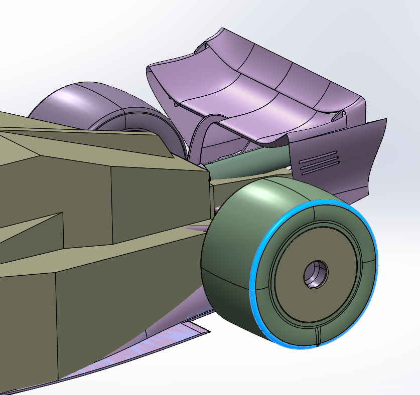

Hi, in the MVRC 2022 thread someone talked about the 2023 wheels and the possibility to improve of the realism of the tyre wake.
From my point of view (I am the tyre supplier mentioned in the MVRC emails ;) ), the geometry 2023 will inlcude small updates, in order to match the real tyres shape. More specifically, the edge of the rubber will be more rounded for both rear and front wheels, this will have a significant impact on wake.
Nevertheless, I think that the shape of the wheel wake also depends on the mesh in the volume behind the wheel and on the simulation of surface roughness, that are related to simulation parameters.

CAEdevice wrote:
07 Jan 2023, 13:12
I think the tyre shape would be improved if we ignored the tyre deflection. imo the deflection on the current tyres is exaggerated. It seems like outermost shoulder of the front tyre shouldn't touch the road.

Cpatch depends on tyre load and camber/roll/steer etc. IMO what you guys use is quite a square profile for a tyre, getting that right will have a huge influence on how you design your tunnels and even rear wing depending where the upper shoulder wake ends up. I prefer a simple revolute for they tyre shape with a split cpatch and plinth for meshing.

it is time for me to also get involved in these discussions. regarding the tire wake. There was also a comment in the other thread about this. There are many factors that play a role. I think the comment was not totally right as the person did not seem to notice that the slice shown was very close to the floor and not in the middle of the wheels where the wake would have appeared much more pronounced. Now, is our wake super realistic? Who knows, but the thing is it will never really be. Be run rather coarse steady state simulations. The wake will only look more realistic when using averaged transient simulations. This however will blow up computing times and there I think we currently have a nice tradeoff.
I am happy to work on the tire CAD though and have a more realistic tire patch f that is so important for you guys. Here are images that I think help more that what was shown here so far:
https://www.racetechmag.com/2019/03/wil ... s-dilemma/
I have a feeling, I mostly have to change the camber of the front wheels.
