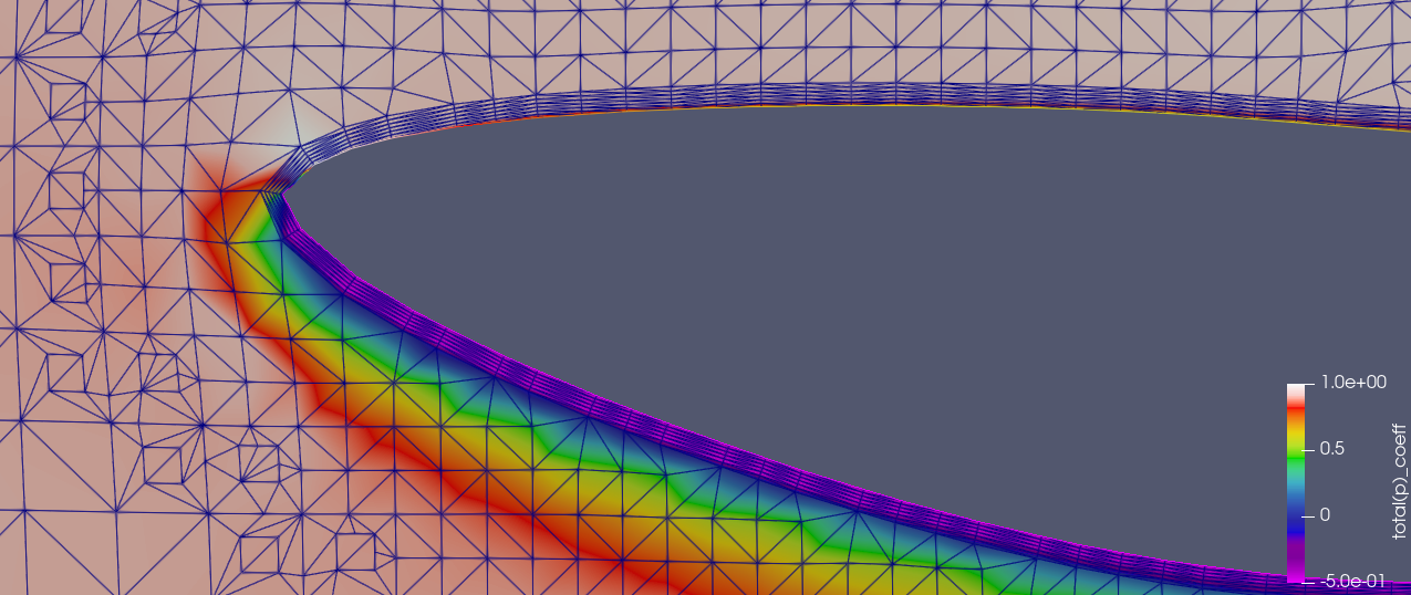

beschadigunc
beschadigunc
Joined: 01 Nov 2021, 22:44
Re: [MVRC] Potential rule changes for 2023
So this image is from a former competitors car which performed well and also has no issues in near wall stuff but this clearly shows the first layer thickness "in the mesh" is way to small therefore it has issues with the boundary layer. the CpT drops below -0.5 at the leading edge and for a pretty thick margin and then the normal boundary layer develops the issue is this is all waaay to thick from what it should be and it is not consistent around any part of the FW or the car , RW and UT boundary layer suffers the same first way to thick no slip effect on the suction side for some reason. Normally to visualize boundary layer growth and CpT -0.5 at a leading edge you would need to go in to 1E-7 m scale but since that's not available here some modelling should be done or at least we can add some really prism layers to the wings . I encourage you all to scale your CpT from -0.5 to 1 and zoom hard into leading edges of your wings. It is a massive issue as the wake carries on for the rest of the body. Basically from this image you can see that in the suction side prism layers the boundary layer starts with - scale which irl really applies to no slip line which is basically non existent for the purpose of this simulation and scales. So the delta99 of the boundary layer at the leading edge should be at maximum 1.E-6 scale which would be invisible to eye in this plot (without further zooming). This really demotives me since its really effecting accuracy of the solver massively. maybe if we can promote better boundary layer treatment at high quality surfaces this can be avoided ? Image
