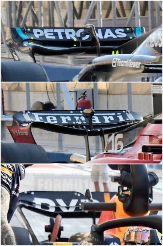

In this view, RB's straight line speed is impressive. They are running a larger rear wing mainplane and beam wing than Ferrari by some margin.
Its more of the same from last season. The Red Bull is just silly on the straights.
1797
Re: 2023 car comparison thread
24 Feb 2023, 07:24
They used two wings in the session, top speed was set with the smaller one you just posted in RB19 car thread :) Smaller wing is still slightly larger than Ferrari wing, but not this much

Vanja #66 wrote:
24 Feb 2023, 07:37
24 Feb 2023, 07:24
Are you sure about that? Maybe I just have bad eyes but I cannot see that the wings are different.
Is there another obvious photo you can share? I'm inclined to believe you, I just don't see it yet.

Is it this one? Terrible angle, sorry.

The Aston Martin, Mercedes, Ferrari, and Red Bull look so very different. I hope no one complains anymore. I do not see any convergence. 4 unique concepts.

24 Feb 2023, 07:46
One has a flat central section, the one you quoted organic with. That one was used on installation laps and later in the evening (not sure about fastest lap) and the other was used during the day. The other is fully curved on the bottom and has slightly smaller angle, like Ferrari and Alpha Tauri.

Interesting how much RB has taken off the top of the FW endplates. Not that it would change FW areo at all, but it does change the tip vortex and how it will behave.

So:
- Mercedes is using a RB style wing from 2022
- RB are using a Ferrari style wing from 2022
- Ferrari are using a Merc style wing from 2022
