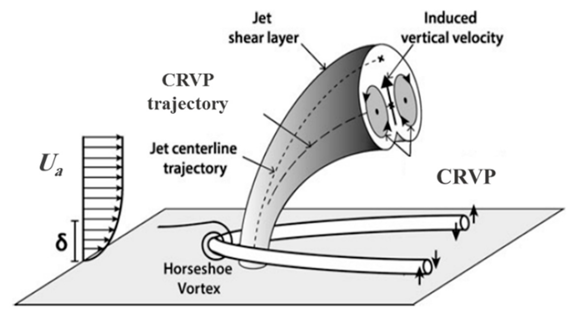

@atanatizante
Stella used the word "vertical" so clearly no large scale spiral motion. The assumed two vortices run along-side each other and do not spiral around each other.
There are quite a bit of ways Newey and Co. are creating a vertical structure. And perhaps if other teams are doing it, RedBull just do it a lot better!
Just rotate the examples below by 90 degrees and play a game of seeing which features on the floor are best fit.
Counter rotating pair via wavy flips
Counter-rotating pair via jet cross stream
Counter pair by impingement
