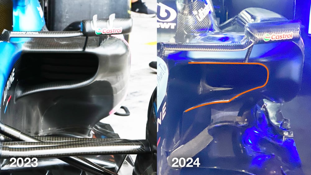

The reders really look like they extended the sidepod inlets into an s-duct like inlet. But not on the real car
Oh also in the real model! You can see it here

The sidepod opening does look like it extends all the way down on the actual car, we got a sneak peek at it during the presentation, matches what is somewhat visible on the renderings.

We can see it on the real blue one, but not on the purple

Difficult to say if it's a proper imitation of Ferrari's concept or an additional area of cooling. We need to search if there's any exit hole in the back of it

Sidepod inlets don't look to be super small/thin on top, so I doesn't seem like they need any additional air for cooling purposes. I'm not sure but it looks like they want to remove boundary layer. In some way similar to what Ferrari did last year.

SP inlet with vertical extension would suggest s-duct

Pretty sure they want to remove the boundary layer there, but remember that Renault PU has always required much more air than the others

Hard to say if it's "just" a boundary layer separator or an actual (S) duct, but it's there.
The team didn't really do much, if anything, for pressure recovery on the engine cover and the whole rear end. What's more, those sidepods are quite wide and have a modest undercut. The nose is quite wide as well. Not looking good for their top speed performance.
Hello there, hidden sidepod tunnel. Or should we call it under-undercut
Well, that's another way to separate airflow :mrgreen: Good to see at least some innovation.

What do you mean with separation? and didnt RB have this kind of under undercut last year? (I barely watched f1 last year)

This small tunnel effectively separates a part of the flow in the undercut completely from the outside flow. Probably gives better predictability in yaw. This is the first time any team did this. If it's a valuable development, we might see copies of it in April or May.
