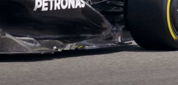

It seems that on the last day of testing, they changed even the front upper rear leg wishbone to test the anti-squat, as Allison said to Lawrence Barretto because it was the only chance they had this year to do this kind of testing ...
Has anyone got some pictures to prove those rear suspension changes they made?
One piece of evidence could be to spot at the rear of the car the same panel they`ve designed for the upper back arm at the front suspension ...

The ultimate aim of geometry "conflict" is to keep the platform stable (obvious aerodynamic advantage could be there) while separation of this function from conventional spring rate etc to achieve it.
Obviously they are interelated, but that's the reasoning generally. In other words, IF you can keep the aero platform stable ftom this effect, then there's more room to play with spring rates for things like curb compliance etc.
Conflict in suspension ? It's making a geometry that resists, through It's geometry, the forces that are placed onto it without recourse to compression of the spring medium.
This, fully exercised, usually brings driver response of "inert" description in both cars and bikes, making it harder to fit within some driver's methodology and experience, which can go either way in pace and recognition of the real limits of adhesion as that approaches. Its a very liquid area of driver interpretation.
The best can describe this to their engineering team in ways that will then be interpreted with justified changes, a extremely nuanced response feedback loop.
Different drivers likely to feedback in possibly opposing report. A lot of thinking to do in reality, then to be checked against the clock.
It would seem unlikely to turn up to a race weekend wondering, more likely to define the effects now, then perhaps pinpoint various circuit characteristic that would enable the team to start with a bias there in prediction of that heading the chassis to favoured balance for that weekend.
