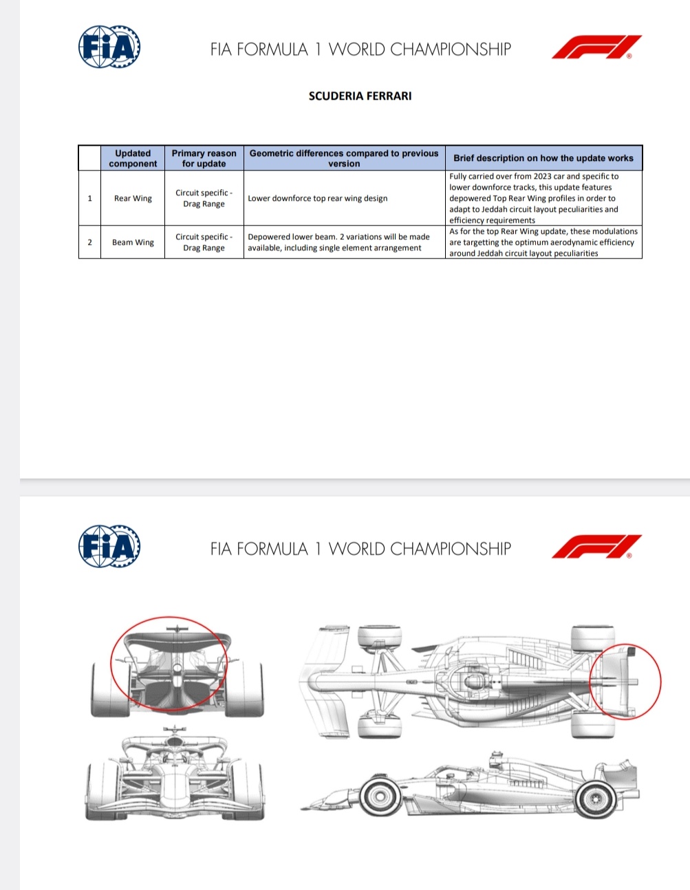

Still has the medium downforce spec mounted. I'm sure this will change sometime this weekend looking at everyone else's choice. Even though this wing with a single element beam wing was my prediciton I tend to agree with Vanja's prediction of the Spa 2023 wing.

I hope they run 2 different wings in FP1 to evaluate the differences. Worried if they’re planning on running medium df the top speeds will be too compromised as per last year

Personally I think technically wise they know they are doing. they need to sort out things on the operational side. Last week they failed to maximize the result in quali and then the big issue with the brakes in race. They need the practicality of their main rivals.
Re: Ferrari SF-24
If Ferrari changes their RW it will indeed be for the 2023 model.

Spa wing as predicted

Ferrari is sticking with it's Bahrain rear wing so far.

I can’t tell if they’ve switched beam wings. It looked like it on Sainz car but I’m not 100%

I think they are running single element.
