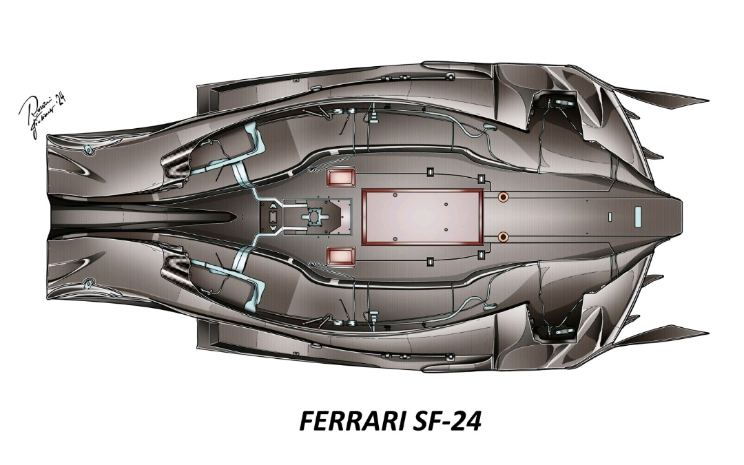

Re: Ferrari SF-24
Assuming the shapes seen from the top match the shapes of the underfloor (they should, in general), here are some details we can observe. Blue circles are areas where we can observe some downforce-generating features, yellow is pressure recovery around the gearbox case and red lines are outlines of the tunnel to the best of my understanding.
Starting at the front, bottom SIS tubes required a slight dent in the floor shape. It looks like it traces on the underside shape, making it a convex surface. Convex surfaces accelerate fluids going over them, which generates suction, ie downforce on race cars. Right in this area the main vortex sheds off the fences, enhancing the suction effect here.
The unexpected bit happens right behind this zone. Two smaller blue circles generate a lateral kick which ads lateral convex curvature helping with a bit of downforce generation, but this bit was adopted by all teams since RB18 floor was on display in Monaco Q3. Going outward a bit, we can observe a shape that suggest right there the roof of the tunnels starts going down. In hindsight, this was visible from earlier undercut photos, but we couldn't know how high or low the tunnel roof actually is.
Behind this area we can see the tunnel starts expanding laterally but keeps the same height. Overall, I would say this part of the underfloor - starting from the SIS tube and just slightly behind this lateral throat is where the bulk of the floor downforce is generated. Once all these effects are combined (lateral throat, floor fence vortex and SIS tube bump), the suction/downforce is generally amplified. The nice thing here is there is very little risk of throat stall/choke since the throat itself is quite high, fence vortex is the strongest in this area and the lateral expansion is driven by the floor edge vortex sucking the air outboard. To put some illustration to it, we are talking about the purple zone on this Cp plot (full topic link brought to F1T by Aero Wizards Vyssion and jjn9128)
This type of floor throat would be driven a lot by a strong edge vortex, which is, in turn, driven by maximised floor inlet area among the floor fences, which is exactly the case on SF-24 and a continuation of SF-23 development since it's launch.
Overall, the floor philosophy is just like it was in early F1-75 spec - a typical Venturi tunnel with lots of features to enhance the floor. The changes in tunnel roof height aren't unexpected and Ferrari clearly sacrificed raw downforce coming with low throat for a design they managed to improve massively since Barcelona 2023, where they first raised the tunnel compared to launch-spec floor. There don't seem to be complex surfaces which can be seen on RB19 Monaco floor and which are likely even more complex on RB20 now. This is not surprising, there was never any chance to catch up to RB by copying them - see AMR and McL.
Further back from this throat there is amore lateral expansion with almost no change to the tunnel roof height. It's hard to say for sure, but right around the rear lateral kick on the central boat section there seems to be a gradual increase in height, ie diffuser expansion. The central boat section has a rear kick, a carry-over feature since later last year, in 2022 this was a typical canoe stern shape aimed only to reduce drag with pressure recovery. Furthest in the back, there are two large outwashing flicks on diffuser walls. These are there since the launch 2022 spec and have grown considerably.
Overall, when I see how fairly high the tunnel seems to be I'm surprised at the downforce Ferrari floor generates. What's more, there is definitely a lot more performance to be found by carefully introducing more geometry features and possibly lowering the tunnel step by step. After the race today, I will try to find the best photos of SF-24 from both races in different corners to compare how high it was. It might give us further insight into how Ferrari solved the bouncing and floor performance in the race compared to last year.

Re: Ferrari SF-24
Vanja #66 wrote:
09 Mar 2024, 18:08
https://i.ibb.co/gTy0tSw/sf-24-floor.jpg
https://cdn-1.motorsport.com/images/mgl ... etail.webp
https://imgur.com/1wXjL5V.png
https://i.ibb.co/hKbbDpf/2-GGN1-K83-W4-AAR8o-I.jpg
I expect the fairly high tunnel may be one reason why the car is devoid of porpoising/bouncing (unlike McL and Merc) as was theorized to explain RBR lack of bouncing since ‘22, yes?
As far as the floor topology, we can make out that the shapes (highlighted below) at the trailing edge of the diffuser appear to be protruding into the diffuser area—so is this ‘blockage’ meant to drive flow into the outboard corner of the diffuser roof or (and ?) alter flow behaviour/attachment at high speeds vs. low, and DRS on/off?
ing. wrote:
02 Mar 2024, 00:36
Are the “shaded” areas pan-downs, or raised? Wonder if this is used to either keep flow attached at speed or, conversely, promote a local separation at speed to reduce DF and drag? 🤷🏻‍♂️
And are we seeing little stream-wise fences (arrows)?
1795
Re: Ferrari SF-24
ing. wrote:
10 Mar 2024, 06:33
Yes, higher tunnel is the main tool to fight porpoising. RB is doing some things differently from Ferrari to add downforce and have some sections of the floor which are actually quite low now.
As for the diffuser outlet, the new shapes are indents, increasing local curvature. I think Ferrari were clever here, they are combining RB design (until mid-2023) with diffuser flick up and their original corner indent which has evolved into its own outwash flick. This area could potentially experience a bit of a suction drop with DRS, along with the beam wing. To be clear, this happens to all cars when DRS is activated, it's not RB magical-diffuser-DRS-stall :mrgreen:
