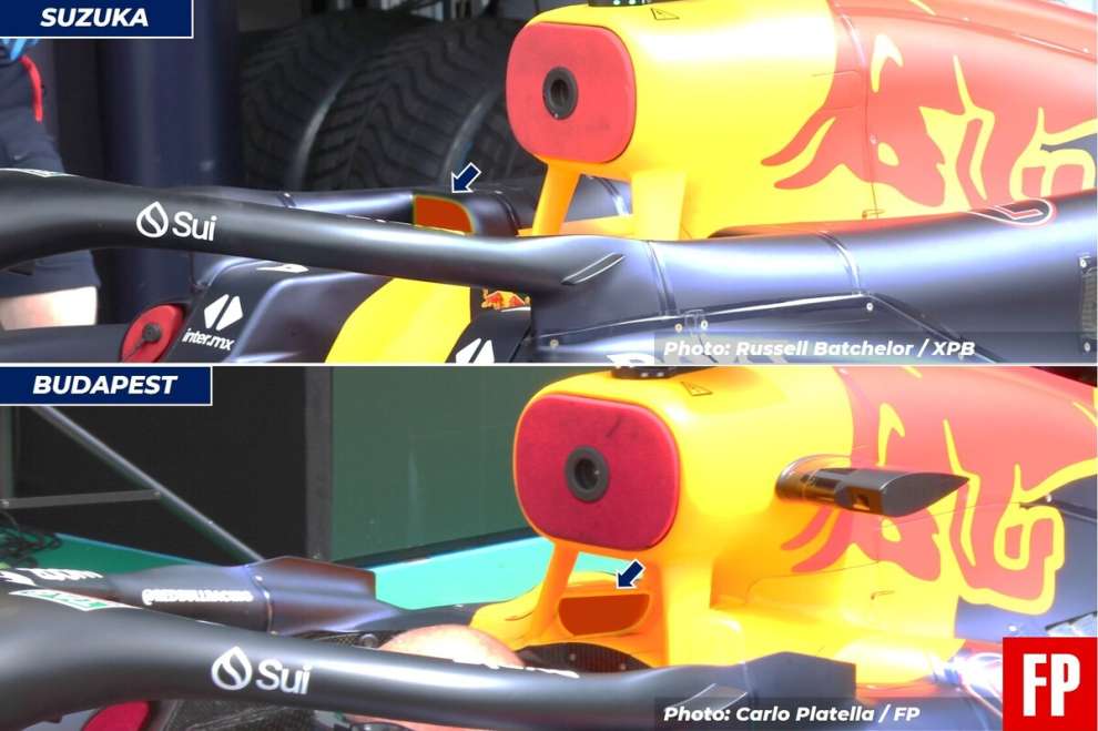

Re: Red Bull RB20
organic wrote:
19 Jul 2024, 12:13
Behind Halo inlets are gone
As per F1TV, there's new inlets below the airbox behind the driver's head instead.

Re: Red Bull RB20
Matt2725 wrote:
19 Jul 2024, 13:24
organic wrote:
19 Jul 2024, 12:13
Here I guess

organic wrote:

Yes they are. I was a bit amazed nobody is talking about them until you posed. They are quite clever inlets. They suck in low quality air at a high pressure. It may be these inlets that void the necessity of the halo gulleys

Re: Red Bull RB20
SiLo wrote:
19 Jul 2024, 13:18
The inlets behind the driver were quite large, where has that cooling capacity gone?
It’s behind the driver still but between the center air box support structure. Carlo Platella on twitter posted these images.

Weren't these inlets behind the driver always there?

Yes but they're now rotated by 90 degrees and eliminated need for the gutters

organic wrote:
19 Jul 2024, 18:53
f1isgood wrote:
19 Jul 2024, 18:31
Henk_v wrote:
19 Jul 2024, 17:00
https://i.imgur.com/CJK4v5W.jpeg
https://i.imgur.com/28FYZ8z.jpeg
Ah, subtle. Thanks sir!
