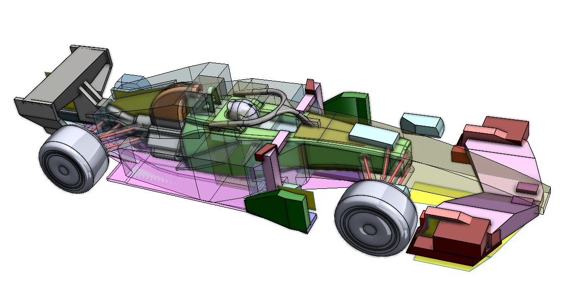

For the moment I would like to share the CAD model of the legality volumes for MVRC 2025 regulations, which is inspired by (but not coincident with) the FIA F1 2026 rules (the differences concern both the volumes themselves and the management of the distance between the wheelbases and the dimensions of the safety cell, which in our case is fixed). These volumes will be used by the STAFF as a reference to write the rulebook.
The following first proposal is a R00 version: some details are missing, both because the final FIA F1 2026 rules are not yet fully defined, and because some volumes (e.g. front wing) will be simplified, as was the case for the MVRC 2024 regulations. The reason for releasing this preliminary draft is to involve the teams in the open source development and discussion of the geometry, without anyone being able to take advantage of it.
As you can see, unlike the FIA F1 regulations, I have prepared some common elements: extended safety cell, suspension, power unit, accessories.
CAD models MVRC R00: http://www.caedevice.net/SERVER/MVRC/20 ... RC_R00.zip
(Released with GNU GPLv2 license, no commercial use allowed).

What i would like is obviously the new 2026 regs but i dont know if it is achievable in a reasonable short time. There is a grabcad post with the 2026 legality volumes but i dunno about how legit it is.
Apart from that, maybe updating bluecfd released to the 2024 build that uses OF12 if the change has any gains to us.
Edit: Ah Matteo beat me to it :D

The GrabCAD model is good, but even less up-to-date than this one :|

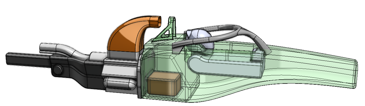

I put a detailed image of the proposal for the common parts: by isolating the safety cell and the power unit, I tried to simplify the rules of the airscope area. You could do away with the large upper box we had last year, measuring the equivalent pressure on the horizontal surface above the engine and imposing a minimal roll bar structure. Including these parts would reduce the need for rule control.
yinlad
36
Joined: 08 Nov 2019, 20:10
Re: [MVRC] Mantium Virtual Racecar Challenge 2025 (Grand Prix Cars)
CAEdevice wrote:
13 Jan 2025, 19:00
Happy New Year, you will soon receive information on the 2024 awards.
http://www.caedevice.net/SERVER/MVRC/20 ... RC_R00.png
Happy new year all!
This looks great already honestly. I couldn't ask for much more than what I'm already seeing.
Active aero might be interesting but I suspect quite complex to manage for everyone so isn't a deal breaker for me if we ran 2025 without it.
I'll chip in with my usual comments about radiator flow requirements, the less holes we have to chop in bodywork the better but I'm not overly stressed about it, I wouldn't want it to be too easy either

Hello
Any chance to make the monocoque as thin as the engine block? On the lower side only.
