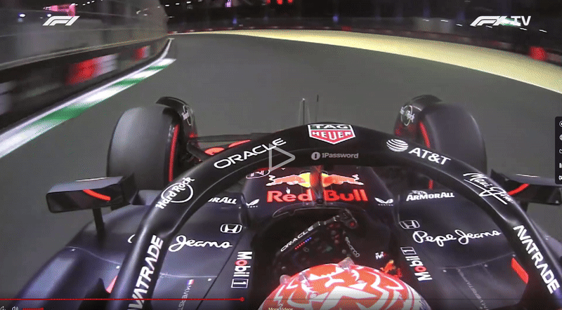

It also introduced a new camera pod to observe the front tyres:
The relentless quest for performance also requires teams to think outside the box when gathering information and data on the car’s performance, with the team having developed a unique camera pod arrangement for use during Free Practice sessions in Saudi Arabia.
The shape of the pods, mounted on either side of the airbox, appear to position the cameras in such a way that the front tyres can be monitored more effectively, whether that be with a hi-speed camera to better understand the tyres deformation, or with a infra-red camera to gain further knowledge on how the tyre temperatures evolve during the course or a lap or stint.
https://d3cm515ijfiu6w.cloudfront.net/w ... ameras.jpg
I saved a video over the weekend because I noticed the tire sidewall flexing. Look at the left front tire behind the brake duct outlet. I don't think it is specific to Red Bull (in some ways, yes, but all cars have some amount of deflection depending on the amount of lateral acceleration that the car is able to generate from the downforce and steering angle)
