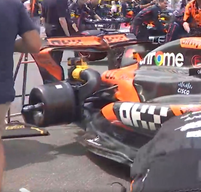

On the grid in Miami

Many theories are coming together at the moment about tire temperature control of the MCL-39. They have a particularly powerful heat extraction scheme in their brake tins which allows them to precisely heat and cool the wheel rim and thus the tire. I feel that the low straightline speed of the MCL-39 with the DRS open is a direct consequence of this. To cool something, you need to use flow energy. They are cooling their tires much more effectively than the others, thus it makes sense to find them at the bottom of the speed traps despite their skinny rear wings.
