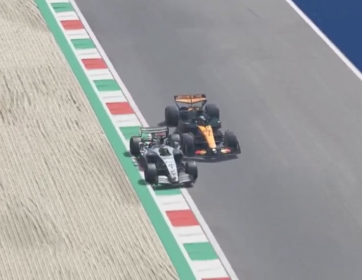

There is a 2026 mod for Assetto Corsa.
They have modelled them much like now, but surely that is for the outwash concept that may not be suitable for the 2026 rules.
Will they continue this way, or go back to something like 2008, or do something different?

How much shorter are the '26 cars expected to be? (or prescribed to be) Not this short I assume. I assume crash structure performance might limit how short FIA-approved cars could become. Regardless, one goal looking forward could be to make Monaco less precessional via narrower and shorter cars.
