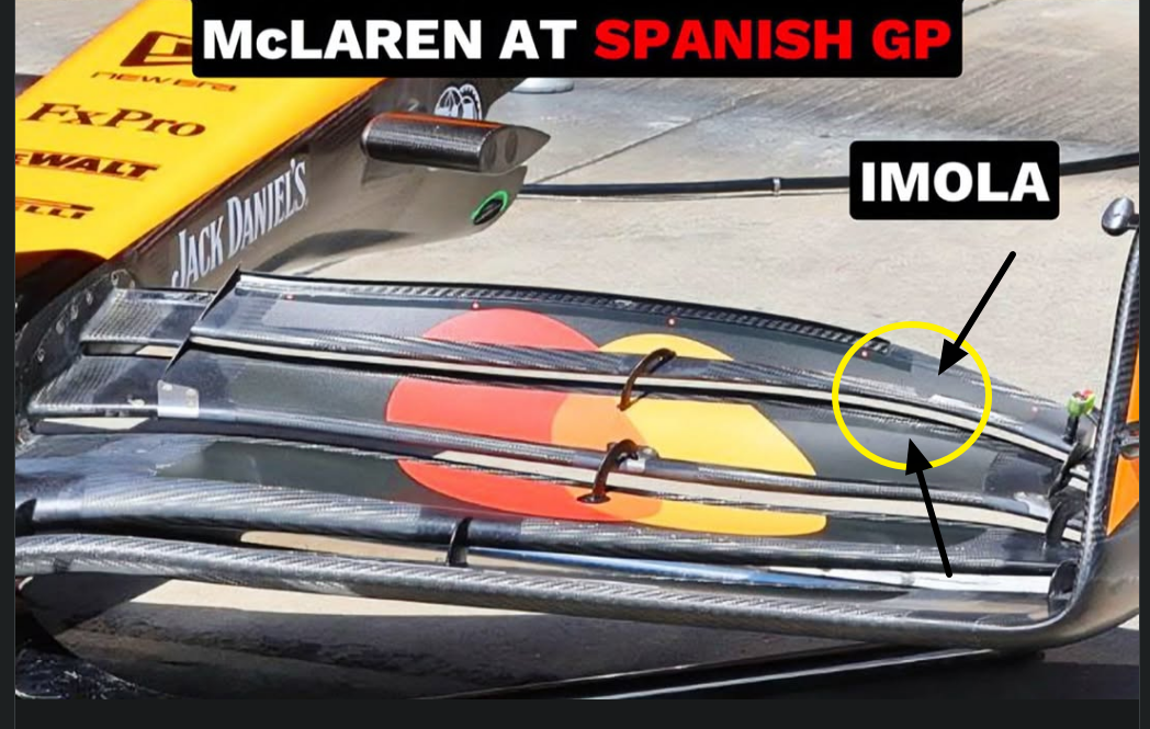

Mclaren's wing from Imola had molding provisions for the update. You can see them in the old wing:
https://i.postimg.cc/90VsVPv9/image.png
Awesome spot. Aligns with the rumour Mclaren already ran a compliant wing (not entirely) this season.
So the carbon fibre weave mustn’t have changed just the bracket and adjuster?
The rumor I saw (by not very credible Ted Kravitz.) was that Mclaren's wing was already TD compliant (That is clearly not true: https://www.f1technical.net/forum/viewt ... 5#p1288695).
Regarding whether they changed the carbon fibre layup, I don't know but it doesn't matter. The wing before Spain wouldn't have passed the test, and if adding the slot gap separators and modifying the adjuster makes it more rigid, then they will pass the new test.
Typical F1 it’s full of ‘half-truths’ which then get spun as stone cold hard facts.
Ted probably knew that the weave was compliant but it needed the brackets to make it fully compliant but he wanted to be the big news breaker so told a ‘half truth’.
Like Gary Anderson said, no team will rock up to Spain without previously testing the a compliant wing before hand.

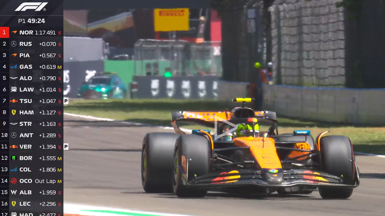

Norris tested it in FP1 at Imola
Was there any wing footage?
skimmed through the onboards and I can't detect it.
Here you go. Ill see if there's any off Oscar.
Thats still flexing a lot if that's their TD compliant wing.

Autoracer saying they tested it in Imola
https://autoracer.it/it/retroscena-mcla ... barcellona
ah sorry, I meant I saw the wing and couldn't detect that it was stiffer :lol:

Update not visible in the first run from FP1 (Imola).

The stiff wing was on Lando's car during second run in FP1 (Imola). They also had flow viz on the left rear suspension. He did a single hot lap on used soft with it, and then boxed again.
