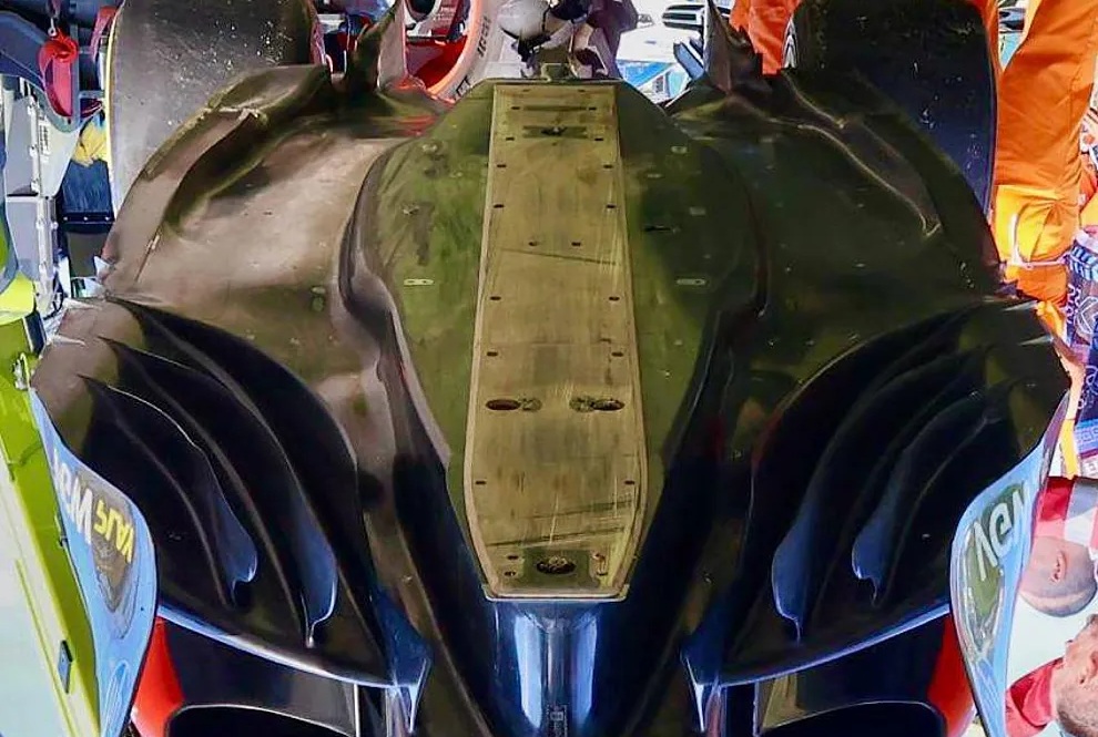

McLaren 2024 MCL38 floor
This is the floor of Miami when McLaren is faster in 2024.
This year, the basic concept should remain the same.
While the Ferrari is positioned at the front of the floor and immediately approaches the road, the McLaren has a gentle slope towards the rear kick point.
The inside of the tunnel is an inner groove, which contrasts with the Ferrari with the outer groove.
This concept has been brushed up from the Red Bull RB18 and has now been updated to a design that surpasses the original and boasts unbeatable strength.
