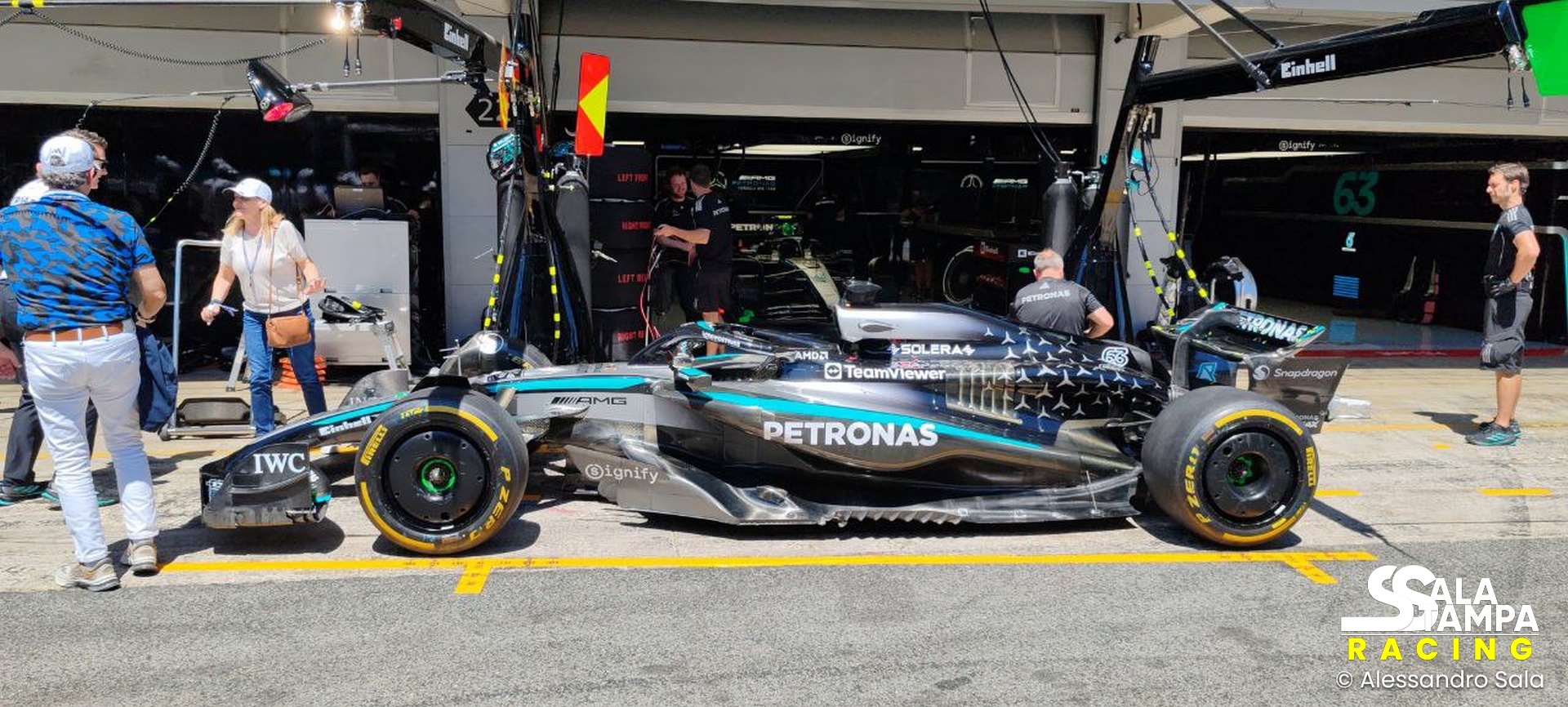

@SalaStampRacing
Is there any possible chance Mercedes gets on top of this and overdevelop Mclaren? They're the one team I know that can do it, the problem is when?vorticism wrote: ↑01 Jun 2025, 19:18These brake ducts are the '17 formula barge boards of the ’22 formula. Merc’s caliper ducting is unique compared to what I’ve seen of Mclaren and Red Bull’s. It's routed around and beneath the upright before making a 180* turn just in front of the caliper.

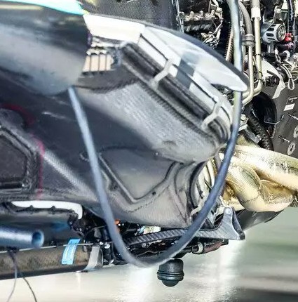

More of a \_ than a <. The lower radiator visible here:vorticism wrote: ↑21 May 2025, 15:36...W16 has a carat ">" shaped radiator assembly, with a smaller radiator located below the main radiators, just out of view. Would explain why the plenum body is so tall--why it dips so far below the main radiators. RB20 also had this carat arrangement, as well as a few other cars longer ago.

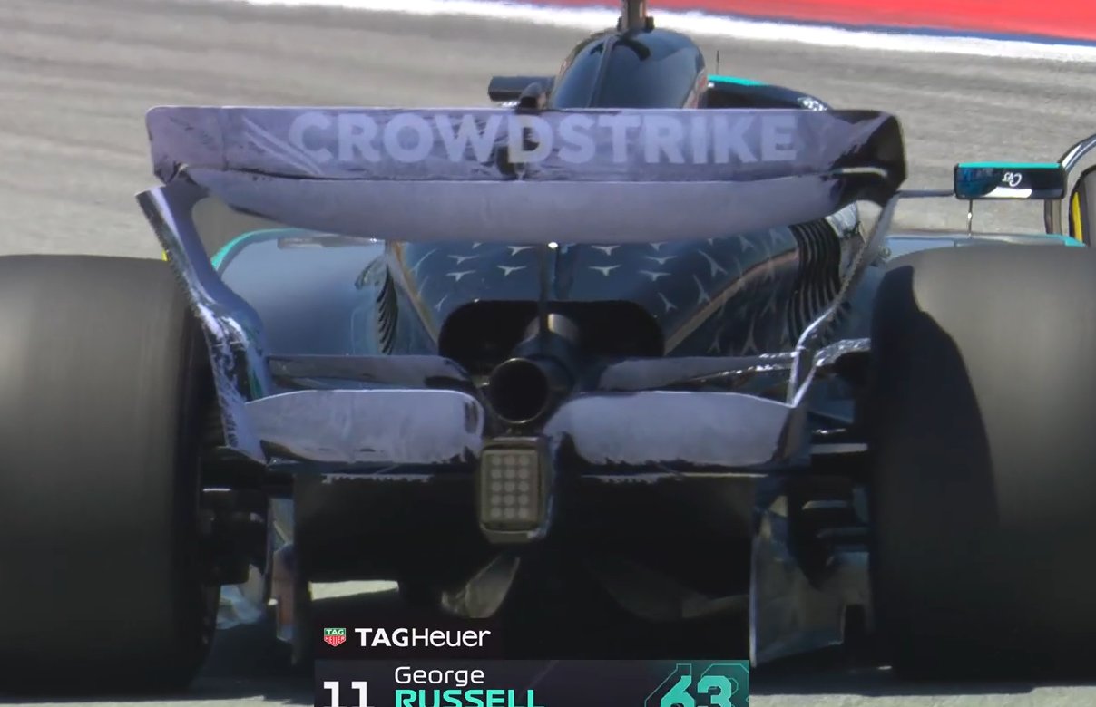

Gary Anderson-ism here....Cocles wrote: ↑13 Jun 2025, 11:37https://www.the-race.com/formula-1/merc ... its-debut/
New suspension is back.
Read on the team thread it will be cooler and it may work to this suspensions benefit given how it was wrecking the rears at the hotter Imola Venue.Mercedes is using the new rear suspension because Montreal is all about braking, turn-in confidence and traction.
The drivers should get more stable braking because of the increased anti-lift, but not turn-in confidence because they don’t have increased pro-squat or traction for the same reason.
This means the car could actually feel worse to the drivers, because it will be changing rear ride height just at that critical turn-in point.

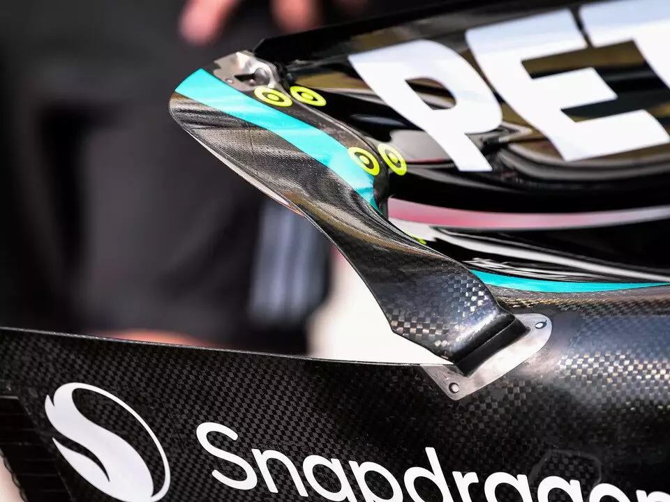

What a lovely piece of detailingLasssept wrote: ↑13 Jun 2025, 09:49https://images.motorsport-magazin.com/i ... 03273.webp
